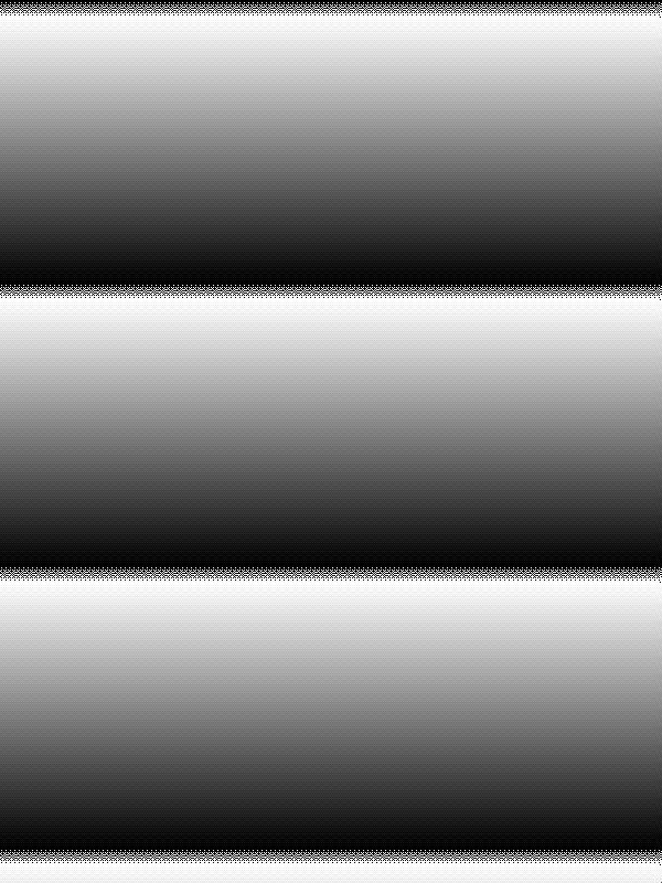

Eink controller documents were studied. Code was written to take advantage of Samsung Broadsheet eink controller for K3 and older kindles (using einkfb device driver) and Freescale SoC-integrated eink controller (using mxcfb device driver), plus the funky hybrid K4 booted from main, with its mxcfb hardware emulation layer using the K3 einkfb device driver. K4 diags is also supported (and I STRONGLY recommend you watch this demo from there to see better performance, but main is not too shabby either). The new code contains a multi-stage demonstration showing what can be done using new interface methods.
All eink updates use ioctl() calls for all kindle models in all modes. New dithering code was written that is MUCH simpler and MUCH faster, and supports full 256-color 8-bit mode (which requires dithering despite the fact that the Freescale hardware has unused dithering support).
The demo shows WHAT you can do. The source code shows you HOW to do it.
The second stage of the demo is very hardware dependent on speed and what effects you see. It is rather slow on the DX, but it gets interesting near the end, and it is followed by MUCH more interesting demo stages.
Be sure to watch this multi-stage demo all the way to the end. There is a special bonus that *I* think is worth the wait.
We are just barely scratching the surface on capabilities here. There is some VERY interesting eink controller hardware here, mostly going unused. Look for GREAT things in the future.
Now, time for the show!

Originally Posted by geekmaster View Post
New dithering code was written that is MUCH simpler and MUCH faster, and supports full 256-color 8-bit mode.
I did notice, though, there's some unusual issues with the dithering, at least on my Kindle3. That part of code is too complex for me to try fixing it.
First, the dither16 (screen attached, no 2) shows some black where there should be white (on the top, for example)
Second, the dither2 (screen attached, no 3) has a very subtle bug, that can observed easily for grays close to 50%. I attached a resized & cropped a portion of the screenshot to show the bug (screen attached, no 4). Basically, one column in 8 is off by 1 pixel.
This is the code used to generate these screens:
for (x = 0; x < MX; x++)
		for (y = 0; y < MY; y++)
			setpx(x, y, y%256);
Keep up the good work, Geekmaster!

@kiri87: Regarding your images showing the kindle 3 comparison of color palettes between wb0 (raw color values), dithered 16-color, and dithered 2-color, I see a clear off-by-one error. In retrospect it is obvious that for "inverted color" devices I need to SUBTRACT the dither offset instead of adding it.
This happens because the "normal" method of 8-bit and higher graphics is 0=black and 255=white, and this is how the new mxcfb device driver for the Freescale iMX508 integrated eink controller behaves. But for the older einkfb device driver used in the K3 and earlier that use the external epson broadsheet eink controller chip, the einkfb device driver assumes that color value zero is white instead of black (inverted color). A complication is the K4. Because it comes with SSH factory-installed in diags, I was doing my initial testing in an UNMODIFIED K4 (factory partitions, and not registered). When booted from diags, the K4 uses the new mxcfb eink driver to get full speed and power from the integrated eink controller. BUT (and this is a HUGE) when booting the K4 from main (with cvm and desktop framework) it runs in K3 compatibility mode using the old einkfb device driver. Not only is this eink compatibility mode slower and a lot more limited, it also uses the old inverted color palette (even when using its 8-bit framebuffer).
When handling inverted color in my older code, I immediately inverted the color value (~color) and processed all pixels as black 0. But for this NEW demo, now that all my code uses ioctl() calls for all eink updates, I instead use the "inverted color update" for the inverted color devices.
Now that I had a chance to sleep on what I thought looked like an "off by one" error at the top/bottom palette transition in the cosmegg demo, and taking the above information into account, it is plain to see that the color inversion affects the dithering so that instead of ADDING one to the 16-color palette when the "unused" bottom bits are greater than the dither threshold (in order to make the color MORE WHITE), we need to SUBTRACT one to make the color MORE WHITE on an inverted color palette. The inversion is now done at the last possible moment by the eink device drivers using the "inverted color update".
So the dithers need to ADD only for the normal color dithers but need to SUBTRACT for the inverted color dithers. I may have already compensated for this in the 2-color dithering... I will compare the two methods and fix it.
Thanks for giving me this feedback that helps me examine this from new directions.

Q2) Would you please explain why you would want to dither 256 colors to 16 colors?
A2) Because the einkfb and mxcfb eink device drivers ignore the bottom 4-bits and only display 16 colors (see my paldemo program for a photo from my kindle screen compared to a copy of the framebuffer). As it turns out, when you copy ANY 256-color images from a framebuffer, the contents have also been dithered just like my code does. You can load a raw framebuffer image into a program like IrfanView and do histogram analysis on it, and you will see that only 16 evenly-spaced colors are used in the 256-color palette (a sure sign of dithering). So the kindle programs that display images dither 256 color images into 16 colors, and any 256-color output I want to display correctly after truncating to the 16 hardware colors must also be dithered to those 16 colors. Because wb0 is not dithered, you can copy it to fb0 and do eips '' to see how it looks with the bottom 4-bits truncated, which can be fixed with dithering like I do in newtrix when the "gs=1" flag is set.
