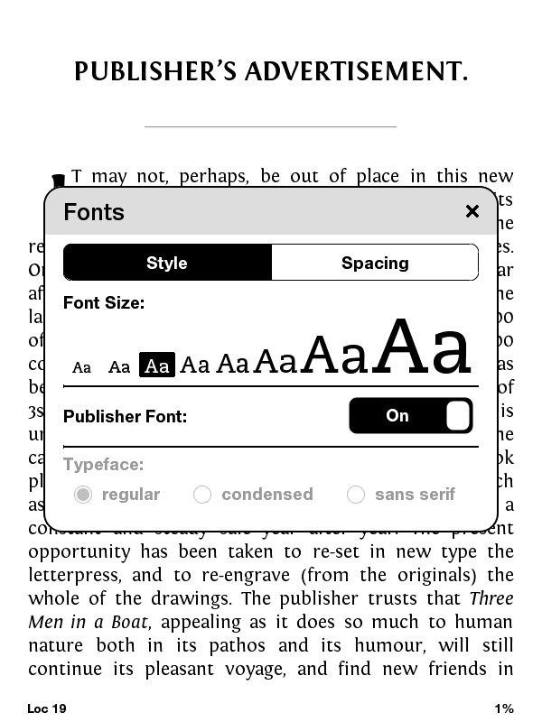

Attached are the original .mobi file and the split .azw3 file.
mobi8-content_nodrm.azw3.zip
Please also check the 2 pictures captured from my Kindle Touch screen and you will know what the problem is.

I couldn't say what might be going on with your Touch, but I assure you that the AZW3 file you uploaded has working embedded fonts and unpacking that same AZW3 file shows that the font-files are indeed properly manifested in the OPF file. The embedded fonts work as they should in the KindlePreviewer (and the Kindle for PC app), but perhaps there is something different about the Touch.
See if giving the file an AZW or MOBI extension (instead of AZW3) makes any difference.

Thanks. I have re-checked the .opf unpacked from .azw3 and the fonts information ARE there. My bad, sorry about that. Looks like it's a Kindle Touch rendering problem now. Let's wait for Amazon's next firmware update then.
