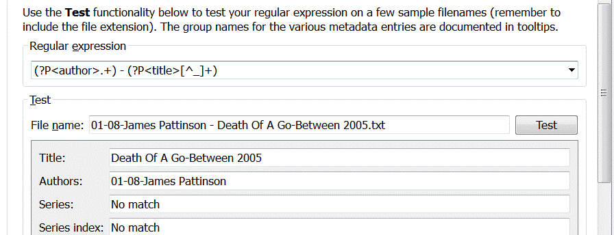

I'm trying to get the expression to ignore anything before the author's name and, perhaps anything after the Title but this is as far as I got.
I'm reading the tutorial http://manual.calibre-ebook.com/regexp.html but not getting far.
Thanks

As long as the filesname follow your example, here's a quick solution.
\d+-\d+-(?P<author>.+) - (?P<title>.+) \d+
If you want the date as published field you can alter it to
\d+-\d+-(?P<author>.+) - (?P<title>.+) (?P<published>\d+)
Perkin is offline   Reply With Quote

Decoding the above:
anything not inside a ( ) pair is not captured and is discarded.
The term does need to match what is there for this to work (at all )

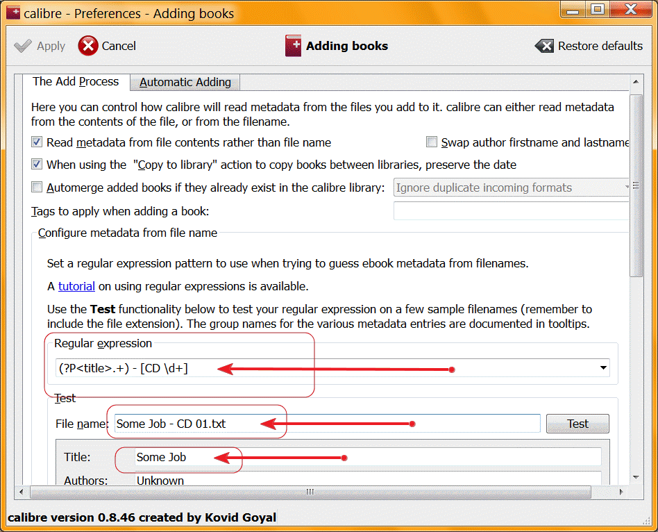

Using a test file and an expression with the above information and everything worked well. (image 1)
But if I drag-n-drop it doesn't work (image 2)
Am I doing something wrong.
Thanks

Remove the [] from the expression, or change to ().
They mean that you want to use inclusive (or exclusive) characters, or a range of characters
e.g. [a-o] means any lower case letter from a to o (a,b,c,d,e,f,g,h,i,j,k,l,m,n,o)
[a-oxz] means any lower case letter from a to o or x or z

Drag and drop is no different to using add. It will use your regular expression for a text file. However I notice you still had "Get metadata from file contents" ticked in a screenshot above, so if you drag/dropped an epub or mobi for instance it is going to use title/author metadata from inside the file, NOT evaluate your regex. If relying on filenames/regex is how you want to do your imports, then untick that other option.
Apologies if I missed it but I haven't seen you post the actual filename of the file you are drag/dropping. I see lots of screenshots of regexes and the result, but not what the actual name of the file is. If your "plan" for the regex was based on a flawed assumption then everyone's suggestions to tweak it aren't going to do any good...

That worked great - I knew I was doing something wrong.
It was the actual file name with the exception that it was an ".mp3" rather than a ".txt" Testing would not allow me to use ".mp3" as an extension.
