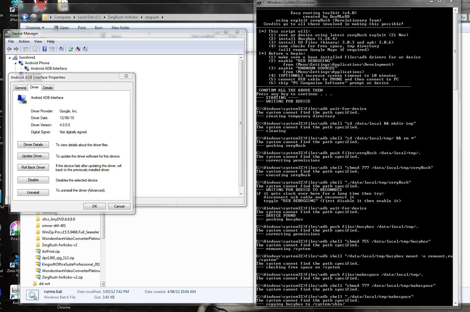

Hi. I'm getting the following error when I run the bat file. The system cannot find the path specified.
I am running Windows 7 Professional x64. Please see the screenshot.
Thanks for any help on this issue.
Please try launching the "runme" batch file from a command prompt manually.
IE, go to Start -> run -> cmd
cd \temp\zergrush-forkobo\zergrush
runme
Good luck!
