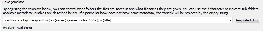

After reading around 20 different threads and still not finding the answer I need I figure it's time to ask the Calibre gurus
I need a template for my save to disk section. Atm I'm trying to use {author_sort}/{title}/{author_sort} - {series} - {title} but It's not working.
I want the file to save on disk with the Author name (ex. Frederik Pohl) - Series + number (Heechee Series 01) - Name of book (Gateway).
Is it doable?

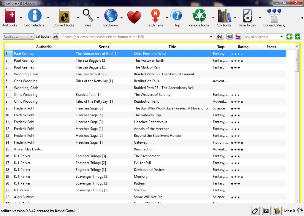

I want the OUTPUT file after the conversion to be saved in the same manner as in the screenshot.
From everything I've read so far this is possible by creating a template (which I don't know how) in the "Save to disk" section of Preferences, but everything I've tried so far ended in a mega fail.

Ok then i'll c/p here what you said there:
Sorting Title After series is nonsense. It is either a Series Or a Title order. It can't be both.
Sorting by Author vs Series is another Priority issue
Try to Sort: Titles first, Authors Next Which leaves Authors with the Titles in order, then sort by Series Which will adjust a few Authors
Maybe I'm just to thickheaded to understand what your saying there or maybe my English is more terrible then I thought.
Your telling me that Sorting books in the main window applies the same "logic" as SAVING them after the conversion?
AGAIN (just to be clear) I need a template for that section of Calibre (see screenshot plz).
??? define specifically "not working"
  • If you want author Fn/Ln order then don't use {author_sort}; it yields Ln/Fn
  • {series} returns only series name; if you want the number you need an additional field {series_index}.

After a bit of more digging on the forum and some help from a friend I managed to find the problem: seems that I was suppose to manually Save the book the another folder/device after I convert it.
After a bit more work I got to this template working: {author}/{title}/{author} - ({series} {series_index:0>2s}) - {title} which is more on my liking.
Ofc your suggestions are more then welcome but I personally know no series being written by any other author except the one who started it (collaborations yes but no different author).
It's a good tip to use the name of the series first instead of author and I promise I'll take it in consideration (at least for the series that have more then one authors).
I have one more problem: after I save the book in another folder the name of the series gets screwed up like: (Monarchies of God, The 01) - Paul Kearney - Hawkwood's Voyage.
Is there something I can do so that "The" is put at the beginning of the name? Or maybe I should just delete it altogether?
