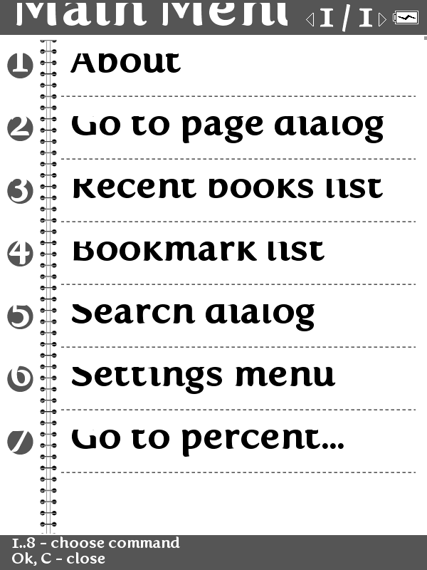

just tried the candy.
it crashed several times (while performing fonts setup in the menu), but apart from that it works and it is cool!!! thanks! I am impressed. Keep up the good work!
A few notes:
1) the menu looks messy because its font size is too big. Are you aware of that or it is just only me who faced this issue? I attached a screenshot.
2) I wasn't able to find a way to "close" the app. is there any way?
3) It seems the app's settings (font settings, enable/disable clock, etc) get discarded on the next app's run. is it a bug?
As I said in the inital post, some fonts make it crash (e.g. DejaVu Sans).
I was really puzzled about this and also the program displaying different fonts with different heights even though the same height was set.
After installing a self built version of the FreeType2 library (that is used on the Touch for handling fonts) all the problems just vanished.
It seems Amazon either installed a broken FreeType2 library on the Touch (but didn't notice it as their code doesn't really use the full functionality of freetype) or they installed a stripped down customized version of it that's not as thoroughly tested as the full build.
I'm not yet sure how to fix that for the next release.
Not yet, that's one of the other reasons why there's no GUI launcher integration yet.
You have to kill -QUIT it from the command line. Or let it crash although since I've added the new freetype2 library it didn't crash for me anymore.
The global settings should be saved as soon as you leave the settings menu and return to the text. But note that different format (epub, fb2, ...) have their own settings.
I think the settings for individual e-books aren't saved. That may be due to the missing of a proper way of quitting the application. But I haven't looked into that yet.

I changed the toolchain, successfully built the app, but I get
line 1: syntax error: unexpected word (expecting ")")
when execute it directly from kindle.
does it mean that the toolchain was incorrect?
varnie is offline   Reply With Quote

I managed to compile it for Kindle Touch (it runs well from the device) but the "menu" is absent. (i.e. it is impossible to invoke it from the application).
And it is impossible to turn pages as well.
The compiled executable file is about 2.7MB instead of '3.3MB' (which comes from your github page).
Any ideas where's my fault?
Touching on the screen does nothing?
That can be due to different CFLAGS. I think my build still has debugging info builtin.
bhaak is offline   Reply With Quote

wait!! it works!!! just tried it again.
BTW, I used /usr/lib/* libraries from Kindle Touch for compiling. I don't see any issues with fonts I had before. Everything looks well.
