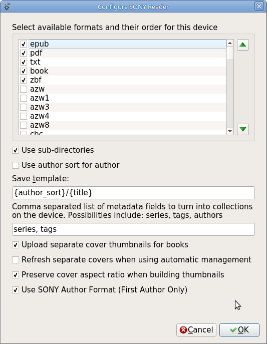

I think my PRS-T1 is recognised as a "pre PRS-T1" in Calibre on Linux?. If the older Sony driver is disabled in Plugins it doesn't connect. The PRS-T1 notes plug in doesn't appear. I see READER and SETTINGS icon appear on the Linux Mint desktop (18.3 and Mate). Calibre seems to copy books to it fine, but calls it "Sony Reader". Disabling the PRS-T1 plugin has no effect, so I'm thinking it's recognised as an earlier ereader?
Settings read when connected:
USB Vendor ID (in hex): 0x54c
USB Product ID (in hex): 0x5c2
USB Revision ID (in hex): 0x226
The Firmware Version 1.0.03.11140
I've downloaded the "latest" firmware, PRS-T1_Updater_1.0.07.05070_a.exe, but how do I apply that via Linux?
Do I have to install the reader software on Win7, or can I use the old PRS-350 "Reader software" on XP?
Is the 1.0.03.11140 too old for Calibre?

Updated from 1.0.03.11140 to 1.0.07.05070 using a Win7 PC, stupid that it's a Windows self-extrator exe that then runs a windows program.
I'm still thinking Calibre isn't regarding it as a T1? At any rate identifies as Sony Reader and no sign of the Notes plug in.
I also think the battery may be nearly dead? Shouldn't show a stripe pattern after unplugging charger at 100%?

The ids you have are what the driver for the PRS-T1 is looking for. The names you are seeing are common to both the PRS-T1 and the older Sony devices. If you open the driver configuration when the device is connected, the titlebar should show you which it is.
The other thing to do is to disable both Sony drivers and run the "Debug device detection" which is on the miscellaneous page of the preference. That should show what is happening.
As to the notes plugin, it hasn't been updated since 2012. It almost definitely won't work with current a calibre. And it probably stopped working with calibre v2. If you run calibre in debug mode, you will probably see errors when calibre attempts to load it.

OK, Thanks. I wonder why then the PRS-T1 Notes plug-in is on the list of plugins via preferences, plugins, add?
I've established that the battery is OK.
Title bar says Sony Reader
Name:	Screenshot at 2019-05-18 11-00-01.png
So why doesn't it use the PRS-T1 driver?
The Highlight/annotation sometimes makes the Reader seem dead, but if you wait it recovers. I'll start a thread on the Sony Reader sub forum.
Because it doesn't state a maximum supported version and it is still valid for anyone running older versions of calibre.
Attachment 171494
Well, apparently I was wrong about the title of the config dialog when it is connected. It is using the generic SONY title. But, those are the options for the for the PRS-T1 driver. So, that must be what is being used.

OK, thanks. So no annotations import for me as I don't normally run Windows. The Sony PC Reader SW on Win7 seems like it was written by the the team that did the awful Minidisk NetMD application / DRM.
