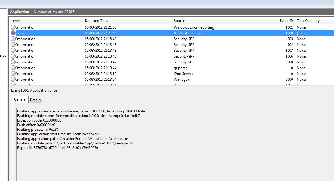

I found the error report for the problem in the admin tools as you said ilovejedd and i've attached the screenshot... From that it seems like it has a problem with one of the programs dll files
I'll try the safe mode option next!

Somehow, to my mind, a crash in freetype.dll would point to a corrupted font in the Windows font directory.
Maybe try some of the steps listed in http://www.ehow.com/how_6917418_corrupt-fonts.html

I've now tried the program in safe mode and it allowed me to get as far as pressing one button before I got the same error... While this is further than i've gotten before it's still crashing almost straight away, so not helpful!
As for the corruption in the windows font file, i've checked that and it doesn't seem that that is an issue. There does not appear to be any corrupt files there...

Do a checkdisk of your hd--if dose not fix problem also do a root scan with a malware program for rootkits. Malwarebytes works well.
PeterT is right most likely a problem with a font.
