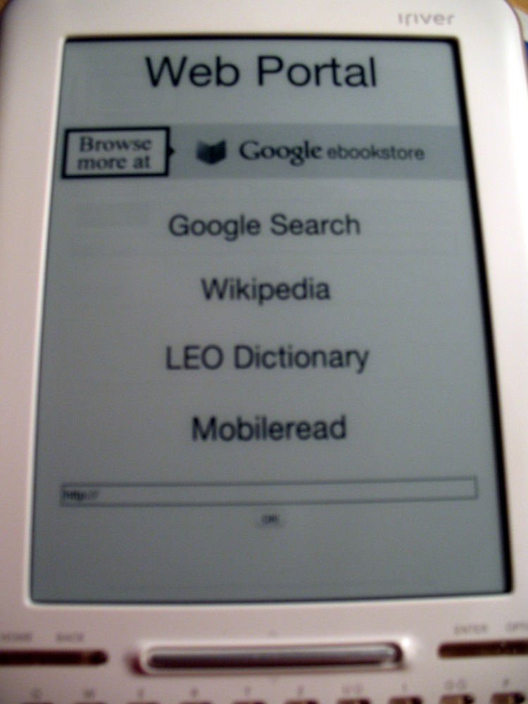

Hi,
Warning: This mod works fine for me, but I can't guarantee it will work for you. Use at your own risk!
This mod puts a portal page in front of the regular Google ebookstore. There you can select various links such as Google or Wikipedia. The ebookstore remains usable - it can also be selected.
The portal is stored in the internal memory as webportal.html, so you can easily adapt the link selection to your personal needs. You should backup that file though as it's overwritten every time you (re)install the plugin, and deleted when you uninstall it.
To use, rename the attached hex file to storyeb07.hex and copy it to the internal memory (like a regular firmware update).
This change can also be reverted by using the attached Undo file. This will also delete the webportal.html file.
The reader requires an additional reboot after installing or uninstalling this mod. Once the update / boot process is finished (when you're back in the readers main menu), hold the power button for about 5-15 seconds until the reader turns off. Then turn it back on and the mod should be active.

Very nice. Maybe you could help iriver rewrite the rest of their software.
Does the picture you show become the main page or is this what you get if you choose the Google book store link? I assume the later but wasn't sure.

You get the portal instead of the book store, but you can select the book store on the portal
