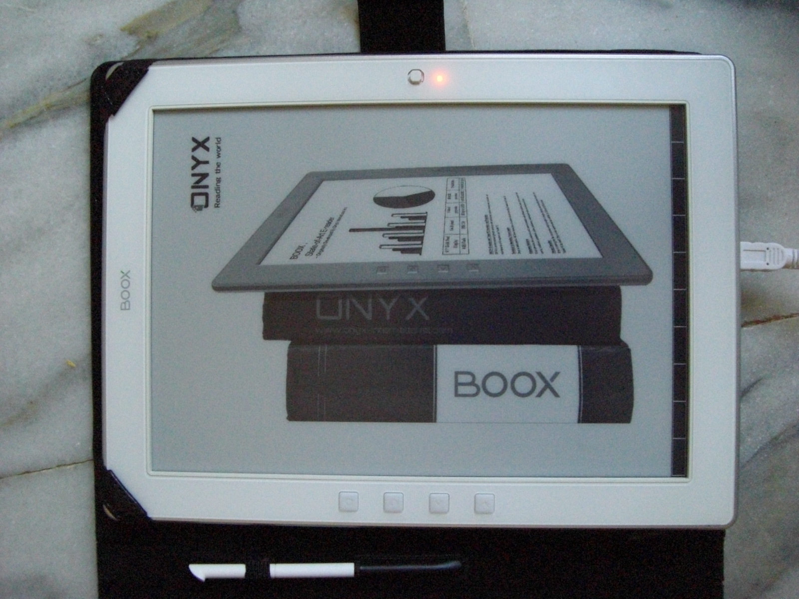

ragasol is offline   Reply With Quote
Old 02-24-2012, 11:00 AM   #194
PF4Mobile
PF4Mobile can teach chickens to fly.PF4Mobile can teach chickens to fly.PF4Mobile can teach chickens to fly.PF4Mobile can teach chickens to fly.PF4Mobile can teach chickens to fly.PF4Mobile can teach chickens to fly.PF4Mobile can teach chickens to fly.PF4Mobile can teach chickens to fly.PF4Mobile can teach chickens to fly.PF4Mobile can teach chickens to fly.PF4Mobile can teach chickens to fly.
Posts: 629
Karma: 3526
Join Date: Jun 2011
Device: Kobo Touch, Nook Touch, EEE 800 Note, Entourage PE, finally M92
Try to go back to the previous version see if that works
This way you can find out if it is the firmware or your SD card or the hardware
For all the people complaining about upgrade problems: It would be helpful if you could mention the speed of your SD card and the model and the maker.
Considering that the upgrade is not a small file the process might get stuck with slower cards....
PF4Mobile is offline   Reply With Quote
