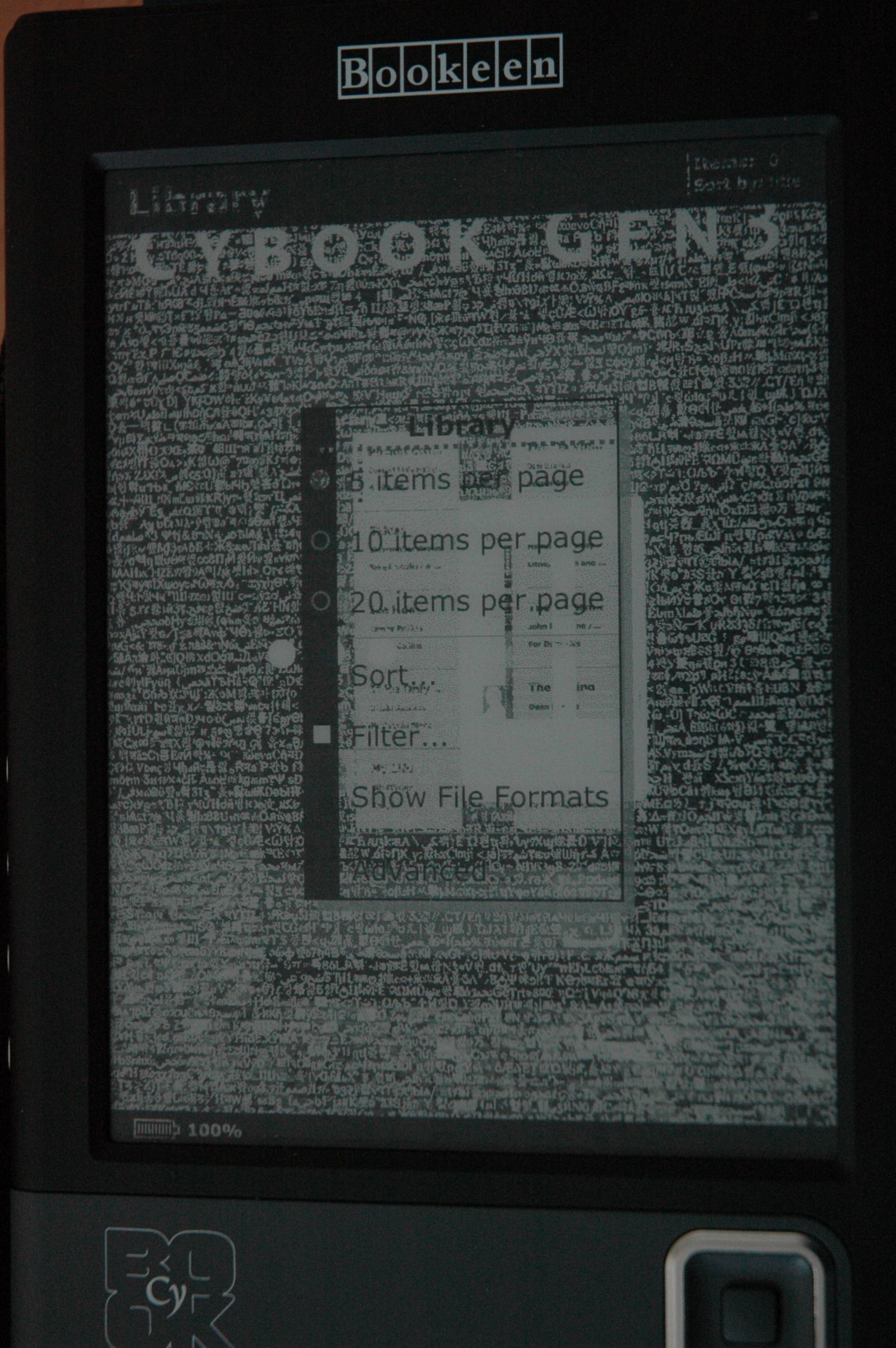

Well, here's an update -
Wrote to Bookeen to complain about the PDF and battery life issues, and they sent me the 538 Firmware.
Tried to Reflash the device, and it was all going smoothly, and the reflash process had started. Then the progress bar appeared to have frozen.
I left it alone for a little while longer, figuring that it was doing something under the hood, and then when nothing seem to have happened for aboy 20 minutes, tried to see if it was working.
this is the result
Name:	Gen3 after 538 01.jpg
As you can see that while the menu options are accessible, it isn't really usable.
Repeated the process after re-downloading the firmware and using another SD card, just to eliminate that factor, but no dice.
luckily, was able tp restore the device to working condition using 685.
So has anyone else run into this problem when trying to downgrade.
(I have one of the new Gen3's with 512mb internal memory, and the battery was fully charged when I tried to do this)
I've written to Bookeen about this so lets see what they say.
bbusybookworm is offline   Reply With Quote

well booken just replied to my email about the reflashing to 538 not working
theyr reply,
It seems that you have the latest version of the Cybook. The procedure we have just sent you is not compatible with this version.
Ouch.

I'd say "OUCH" indeed! Ummm... I got sick and tired of Build 685 so I just downgraded to Build 538. The procedure went flawlessly. Unless they've got "phantom" Build 685s out there, this should NOT have been a problem.
Derek
Derek
I Know, that's what I figured. Even sent in the Serial no and mentioned that I had one of the new models.
So I just downloaded the 538 firmware from bookeen themselves, and followed the steps, and well.... you can see the results.
Do you have the new model with the expanded memory? Has anyone with the new hardware downgraded to 538?

What I think happened was that when I sent in my original complaint, they saw PDF problems?, Battery issues?, Send reply no XX.
When I sent the second report, with the Picture, they probably got hit by a clue by four.
I wonder whether this will light a fire under the development team, now that their easy solution of rolling back to the old firmware is gone.
So have to see how they respond to my request for the firmware it shipped with.
At least some thing's worked under it.
