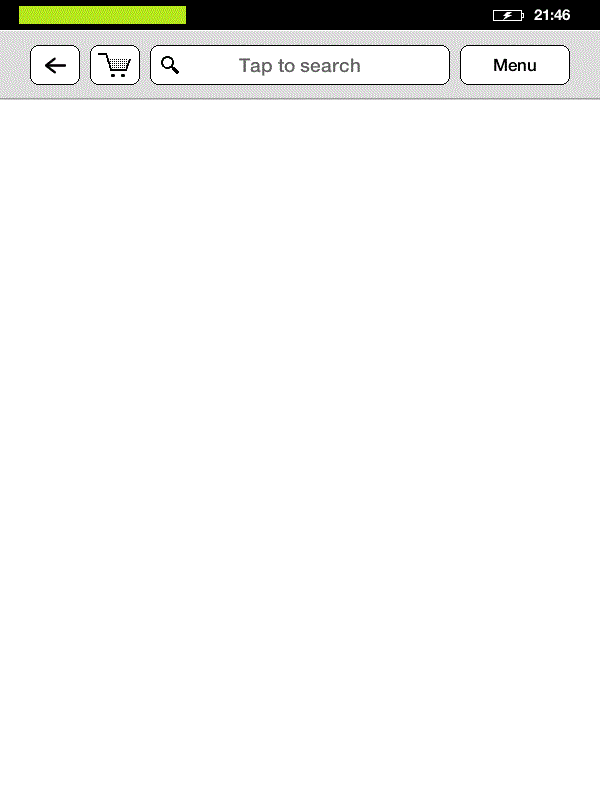

ixtab,
Hmm, tried ru_RU from latest bundle you've provided... (before your very last post)
Still got white home screen (attached screenshot, slightly edited to mask my device name ).
Then invoked international menu from ssh-over-usb, selected English back and got "error while updating: error 3" after reboot, then it rebooted again and was in English.
German localization works fine (I don't understand German but I see that home Menu is translated and some other locations are translated, too).
BTW, when scanning showlog output for some clues I saw a lot of errors like
E lipc:dbuserr:name=org.freedesktop.DBus.Error.ServiceUnknown:Receive Dbus error message (DBUS_MESSAGE_TYPE_ERROR): The name com.lab126.wan was not provided by any .service files
And I tend to think this is the source of my problem.
Some parts of logs also attached (stripped off the part that was before I installed ru_RU locale).
ru-install.txt
ru-select.txt
