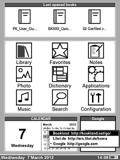

Tip: How to create shortcut for web browser on the desktop
Go to \system\config\widgets\eBook end add your favorite website to eBook.cfg or copy files from system.zip to internal memory.
Then go to widget - select "Change widget" - "eBook" - OK - Widget settings - and select Google.
ID:	83587   Click image for larger version
