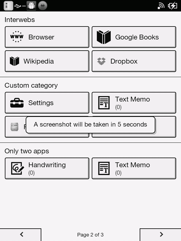

v5
New release: v5 is all about app launcher configurability.
http://morkl.se/reader/homemod_v5.zip
Changes:
  • Favourite apps above 3rd page app drawer as suggested by robyshot. Todo: make the app drawer itself consist of static screens instead of animated scrolling mess.
  • System apps (or any apps whose paths be matched by one or several configurable regular expressions) hidden in app drawer
  • Custom configurable categories on the app screen
  • New configuration file with better structure: homemod.xml replaces extapps.xml and allapps.xml
Cheers!
Edit: Added screenshots of app screen and app drawer.
