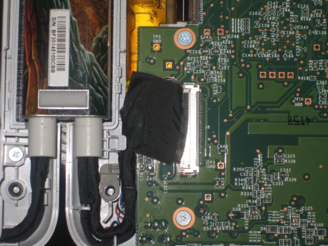

Update on daughter's PE:
Took the cover off, and checked that all cable connections were secure. When I messed with the one in the picture below, the device booted! The photo shows the connection/cable. Notice the wires sticking out of the top and the misaligned black taping. Can we say sloppy assembly?
Rebooted it twice with everything taken apart, then started putting it back together. When I snapped the cover back on to that side of the PE, it no longer booted. I took the cover back off and it did not boot. I plugged the power in to ensure it wasn't a dead/low battery causing the problem, and immediately smoke started coming from the area of the cable. There are burn marks on the underside of the cable.
So - I am in the process of moving the cable from the broken screen PE to my daughter's PE, instead of moving my daughter's screen to the previously broken PE. This new endeavor involves taking apart the hinge. . . fingers crossed. . .

Cables are a weak point - especially those that are bundled together, friction, heat, bad assembly and a few other things will degrade the insulation and, in some cases, produce short circuits.
In your case, you may be disappointed if the short in the cable has damaged any components on the circuit board - some ICs don't like over or reverse voltage.

Success!
My husband broke a little plastic tab thing off the power switch on the motherboard of my daughter's PE, so we ended up taking the motherboard and cable from the 1st PE and putting them in her PE. We also had to switch the batteries, but we now have a working PE out of the 2!!!
There was definitely a short in the cable. All the wires under the tape are bare, and one copper wire crossed over 2-3 other copper ones and this is where it appears the short originated. I will try to post a pic later - busy right now with family things. . .

Well done on getting one up and working.
The fact there were bare wires hidden by the tape says a lot about the QC of the assembling company and some of the problems people have encountered.
