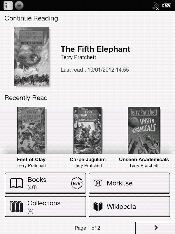

Originally Posted by katnegermis View Post
Nevermind
Did you get it to work? I had an answer in a tab but I forgot to post it and it got buried behind work
Anyhows, I've made a new version. Posted it in its own thread though; no need to keep cluttering this thread up with technical bits
Getting back to topic; i have attached a screenshot of my current home screen, with the Store and Periodicals button replaced!
