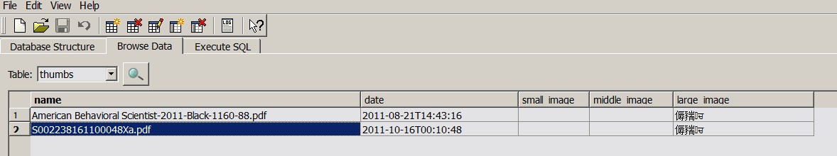

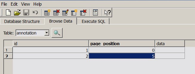

Hmmm
I don't think we have identified all the ingredients yet but we are getting close
Below you have the pictures of what is in those files
Is your firmware Chinese?
You did not indicate if these are annotations or highlights or sketches ...

Just couple of highlights of the portion of a text. Firmware is English, I mean, the standard one.
Hmm, when I look at the .sketch file now, the it also seems to be ordering the highlights according the time taken - 1st highlight was made in p826 ("Economic development ... ..."), 2nd in p1 ("One particularly ... ...") and 3rd in p1 ("States have been shown to employ a wide array of tools to instill nationalism in their citizens").

OK let's stick with highlights then.
I see that it creates a couple of additional files for each book file you read and highlight.
Can you search for all the files with the same name but different extension?
In this case it should be "S002238161100048Xa.*"
PF4Mobile is offline   Reply With Quote

I can't explain the chinese characters at the end of each line in thumbs.db file
they are identical, they are listed under large image
do you think you can add more annotations to the same file and post the two files shown above ? The pdf is not needed any more since it seems to be untouched
