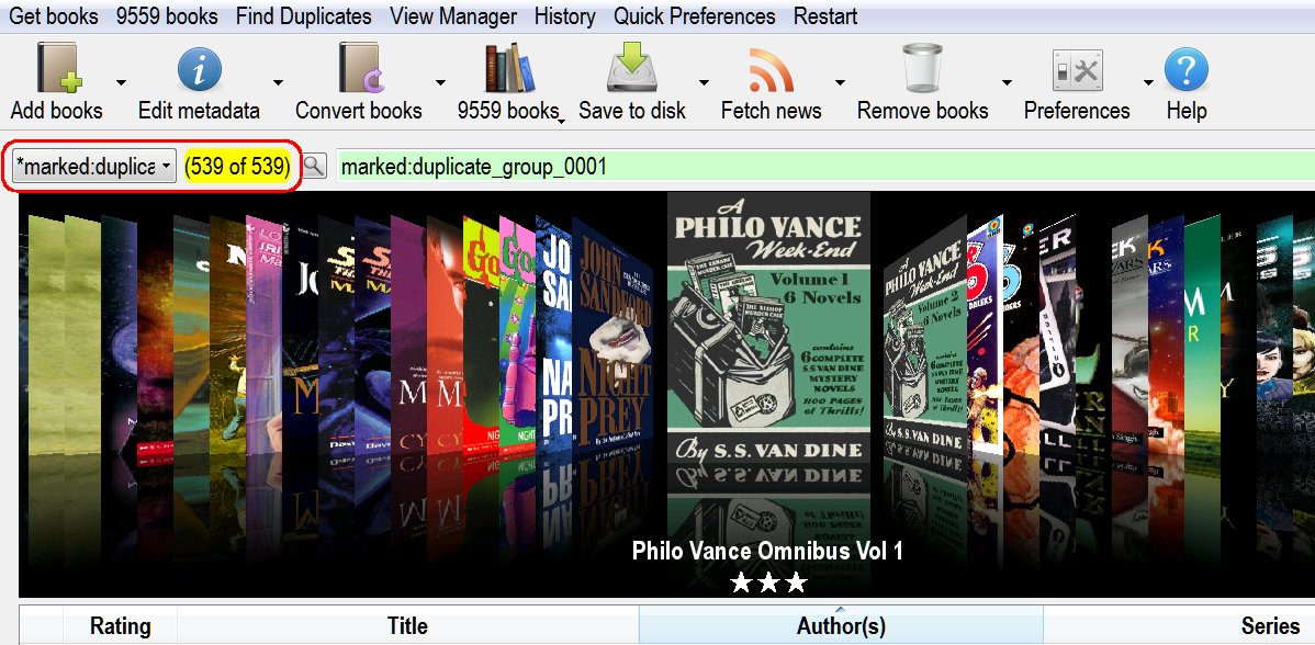

The escape key will clear search results exactly like Kovid states. The find duplicates plugin creates a restricted library / search (see attached) and you are right the escape key will not clear this condition but the Reset Quick Search button will clear this condition. You are asking for clearing two different things but didn't inform Kovid of the difference. Since the escape key doesn't work under both circumstances it follows that the escape key does not equal the Reset Quick Search button.
Ask Kovid again explaining this need where the Reset Quick Search button works but the escape key doesn't and maybe he will have the time to integrate your request.
