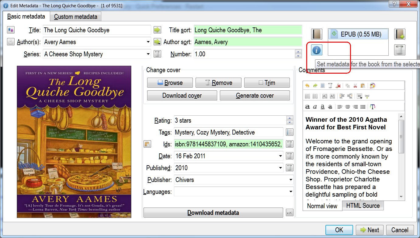

Originally Posted by salines View Post
And now I want to extract the description (if exists) from these epubs to calibre.
Is there a way to extract some (not all) metadata from epubs and update calibre-db?
You can't be selective, but what metadata you can get is available one book at a time via the Edit Metadata window. Select a book, open the edit metadata window, select the format then click on the I icon to Set metadata for book from selected format. See attached.

Thanks dwanthny.
That worked.
