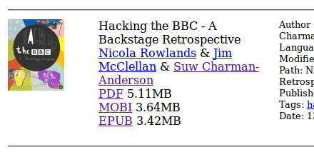

Show the size of the file
The attached patch shows the size of the file next to each filetype.
So, if you're on a limited bandwidth connection, you may choose the epub over the PDF etc.
Screenshot shows a demonstration using the free "Hacking The BBC" eBook.
