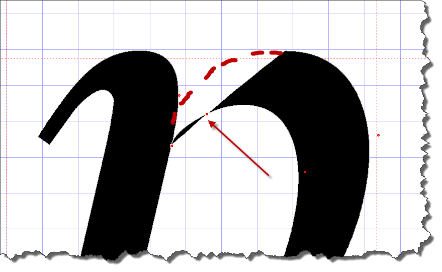

I tried to make a bold version. But I desided not to finish it. Reason:
If you have a closer look at some letters, you will recognize errors like this one (p):
It would be much work to solve those errors. Making the font bold requires to do that. Otherwise some letters will look very strange after transformation.
Sorry.
