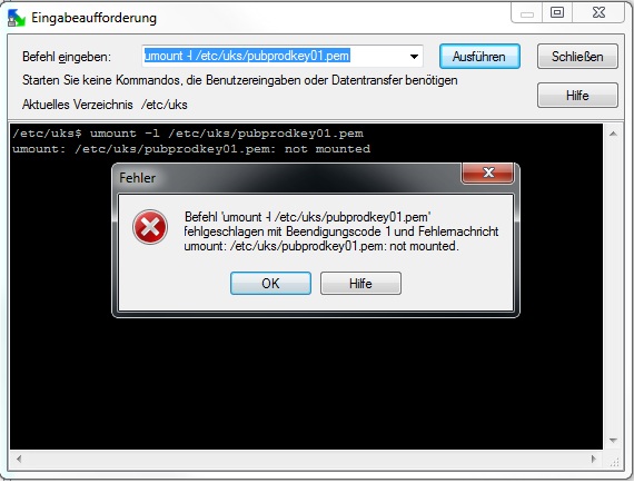

My Kindle has the v3.2.1 and will make a update to 3.3 with the file Update_576290015_611680021.bin. (Automatik download)
But it fails.
I have Backup my Documents and unistall my hacks and make a Factory reset.
updates-provider_0.2
update_loc_de_0.7Mp
kindle-ss-0.22.N
physkeyb0080
kindle-fonts-4.6.N-k3
update_keybru_0.06
readabilitymod-0.1
lpad-pkg-001c
kindle-usbnetwork-0.33.N
freedownload_0.3
kindle-3.2.1-jailbreak-0.5
The update failes again with a error U007 in the left corner.
I have try a full update with the file from the Amazon side. Update_kindle_3.3_B008.bin. It doesn't work.
Can anyone help me?

@z0mtec: Like greyTraveler said, it does sound like there's still some kind of jailbreak/update block still in place. You might want to try uninstalling *everything* jailbreak(s?) included, restart your Kindle, and try again.

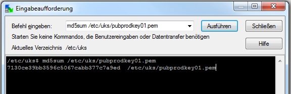

@z0mtec
U007 usually means there's a problem with the signature verification.
You may telnet or ssh to kindle and check /proc/mounts for pubprodkey01.pem mounted or run the md5sum on /etc/uks/pubprodkey01.pem.
If it's mounted or md5 is different than "00cdf09ffae3e6eeb7ad62f0b27fc667" it'd mean that you have a custom key mounted. If you're not using ENABLE_HACK_UPDATES feature just do "umount -l /etc/uks/pubprodkey01.pem" and see if it helps.
ndr is offline   Reply With Quote

The /proc/mounts
PHP Code:
rootfs / rootfs rw 0 0
/dev/root / ext3 ro,noatime,nodiratime,data=ordered 0 0
proc
/proc proc rw 0 0
sysfs
/sys sysfs rw 0 0
tmpfs
/dev tmpfs rw,mode=755 0 0
devpts
/dev/pts devpts rw,gid=5,mode=620 0 0
rwfs
/mnt/rwfs tmpfs rw,size=32768k 0 0
shm
/dev/shm tmpfs rw 0 0
rwfs
/var tmpfs rw,size=32768k 0 0
/dev/mmcblk0p2 /var/local ext3 rw,sync,errors=continue,data=ordered 0 0
fsp
/mnt/us fuse.fsp rw,nosuid,nodev,noatime,user_id=0,group_id=0 0 0
/dev/loop/0 /mnt/base-us vfat rw,noexec,noatime,nodiratime,fmask=0022,dmask=0022,codepage=cp437,iocharset=iso8859-1,shortname=mixed,utf8 0 0
md5sum is 7130ce39bb3596c5067cabb377c7a9ed
I have pubprodkey01.pem and pubprodkey02.pem
When i umount -l /etc/uks/pubprodkey01.pem
then
What can i do?
Can u send me your pubprodkey01.pem?
