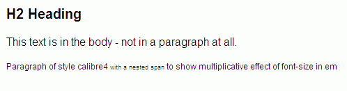

Originally Posted by cybmole View Post
I got the impression that with most attributes the outer one takes preference . so font size is taken from calibre 11 only.
As jackie_w said, font sizes in em are multiplicative. I have attached an example to show this in action. Change the font-size in style "calibre", (e.g. to font-size:1.5em), and you will see that all the other styles get mulitpliied. Similarly you can see that the <span> within the <p> is multiplying the "calibre4" font-sizes and the "calibre" size.
(Save/Rename the attached css.txt file as css.html to try it out).
File Type: txt css.txt (540 Bytes, 163 views)
Last edited by Agama; 10-21-2011 at 02:29 AM. Reason: Added GIF screenshot to show results
