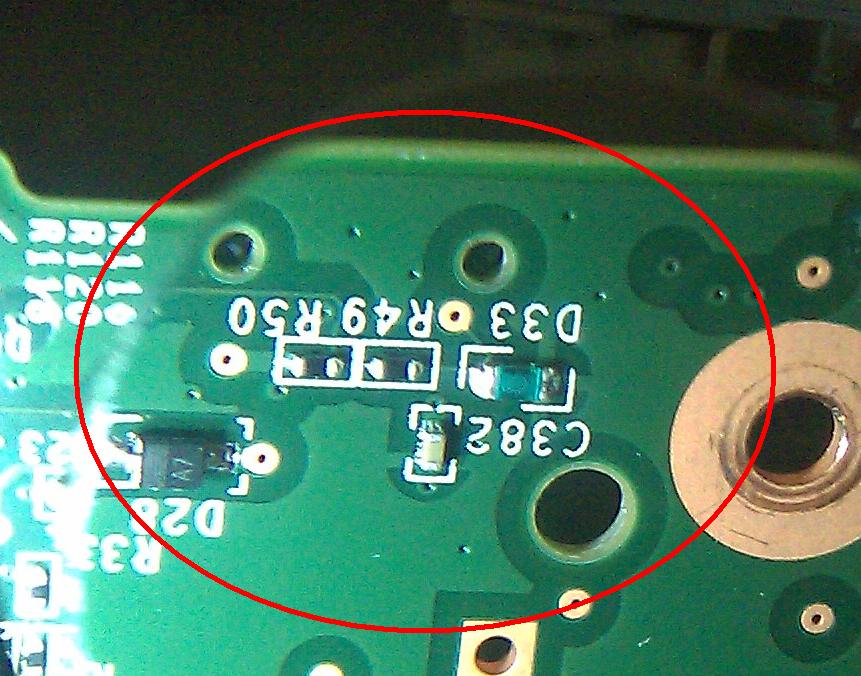

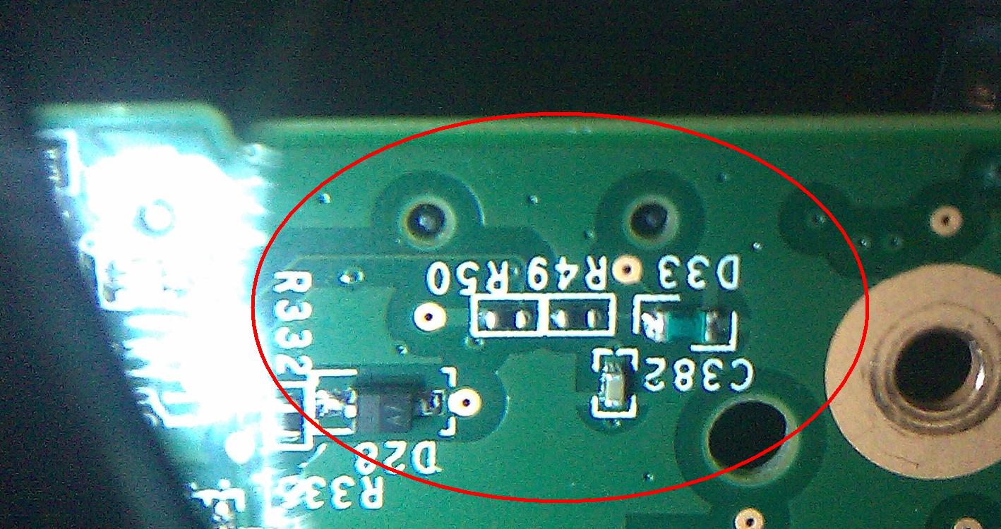

Thanks tekknogenius, my spare parts guy says it looks like a standard 2 pole surface mount spring return slide switch, then he muttered that he couldn't be sure because there wasn't a picture of the back to see the contact spacing.
So, my question, how many tabs are at the back - it looks as if there might be 4 from pic #137 - and what is the spacing between them?
Not sure of the spacing, but I did put two photos of the back of the board where it is connected. And yes it is a "spring return slide switch" (at least that's what it sounds like since you can slide and hold and it springs back to it original position). If you can get a part number I'd appreciate it. I'll also be looking for it myself now that I know what it is called.

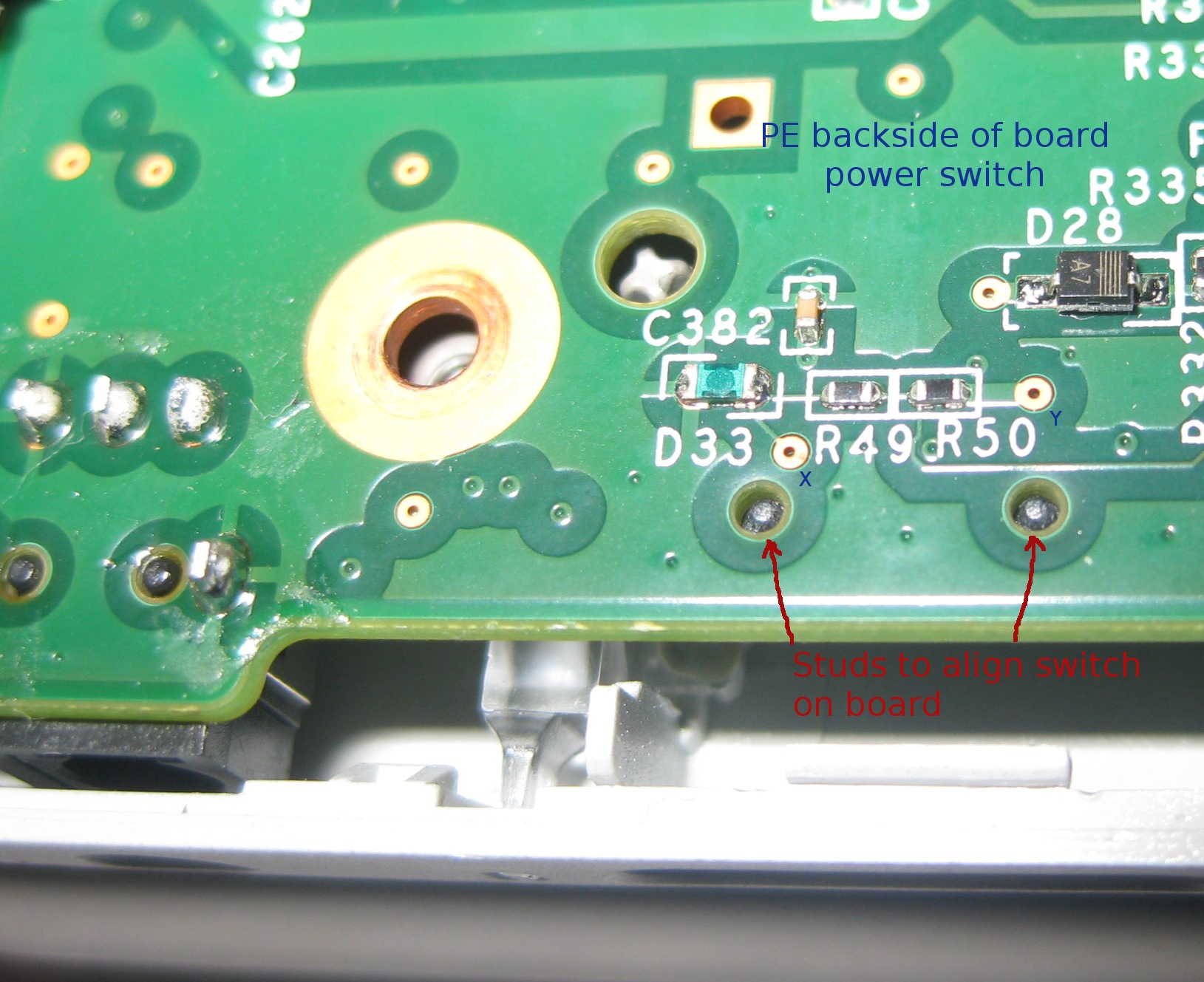

Originally Posted by tekknogenius View Post
Here are some photos of the power switch. Hopefully they will give you some idea of a replacement part.
tekknogenius, some good pics thanks. Your pictures warn me of trying to fix the button!
ivanjt, these components are soooooo small. I was pondering if I have the solder equipment and skills to replace it. I could, for example solder a new power connector on, big solder joints... but without ripping the switch off, I can't even see what I'd be soldering to.
I'd go for a push button mounted at 90 degrees so I could press it with the stylus.
Attached is a picture of the back of the board. Spots marked X and Y might be where you would solder to on the other side. I'm open to comments.
Edit: GAH, I took too long to submit this post, tekknogenious posted very similar pics... but my camera seems better.)

Very good pics both of you. The only problem that I see is that the switch appears to be a surface mount type i.e. it does not have solder pins that go through the board, it solders on to the board on the same side as the switch body.
The picture of the back I referred to was one of the back of the physical switch itself like tekknogenius' #137 only much more of the back of the switch (#137 appears to show it has 4 pins but I can't be sure.

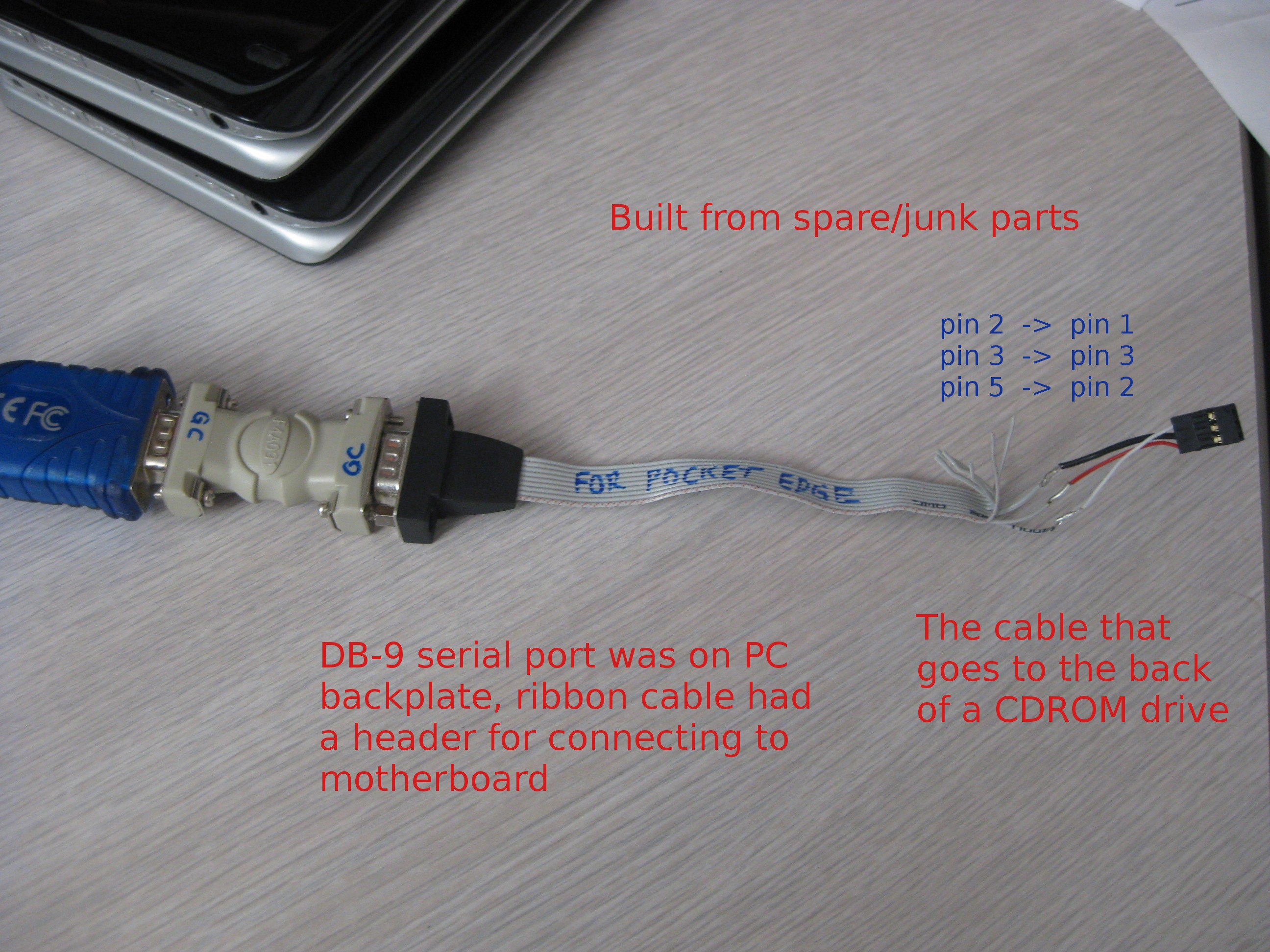

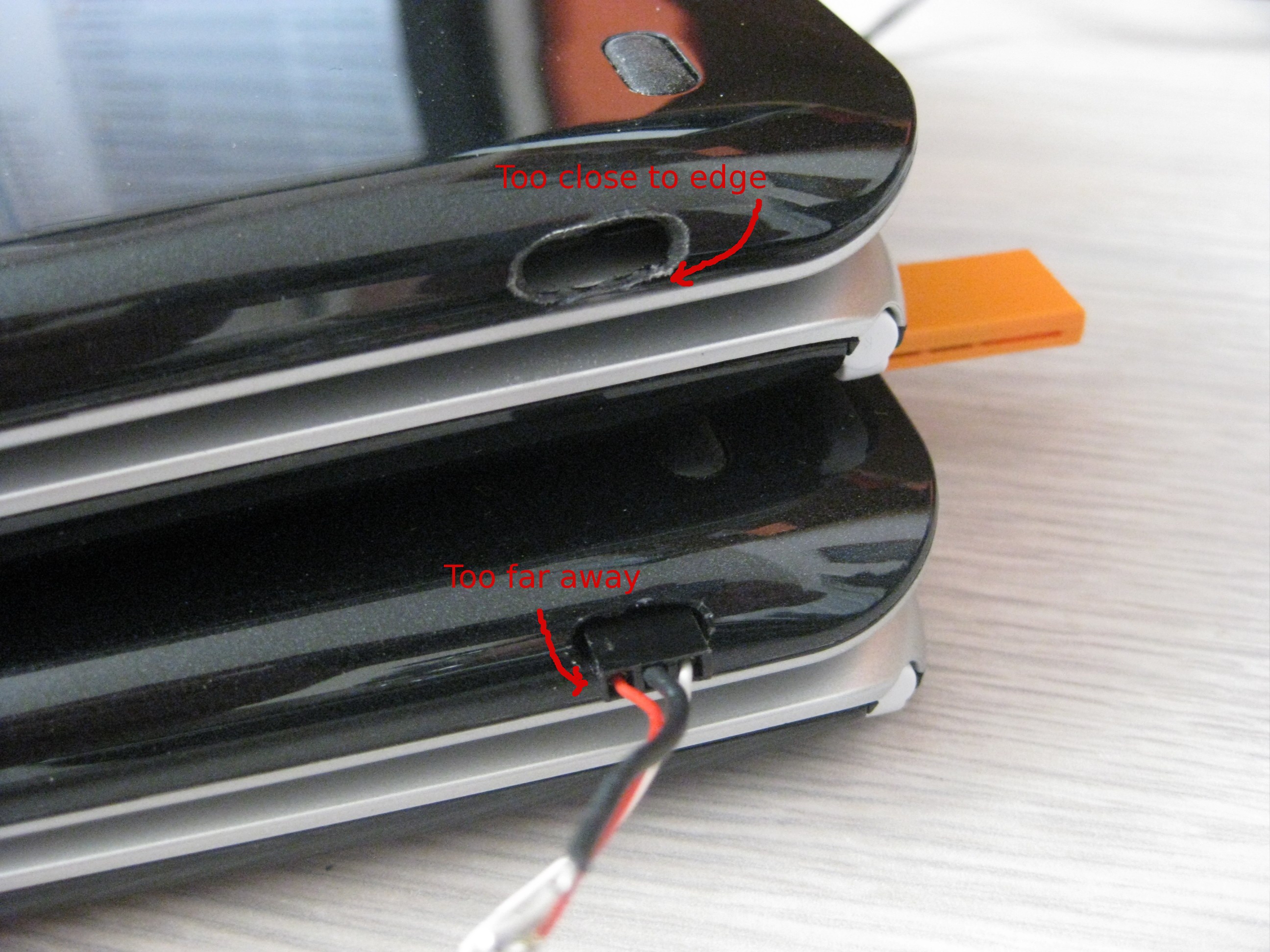

Someone asked about the holes I cut/drilled for easy access to the serial console header.
Attached are my two PE.
One I used a drill from the inside. I made pilot wholes then used a bigger drill bit with the right diameter for the hole/slot width that I desired.
After finding my dremel tool... I dremeled from the outside without taking the cover off. The dremel bit was not wide enough so the cut wasn't quite as nice as the drill. I took the cover off afterward to see how much plastic shavings was in there. To my surprise it was relatively clean, I doubt debris would be an issue if you didn't want to take the cover off. My big problem with this way is you are kind of blind where you are cutting, even if you have one already cut as reference. (don't go too deep, or the wrong way if you see 2 of the 3 pins)
If I had to do it over again, I'd take the cover off and use a drill with about 3 pilot holes, not a dremel. With the dremel I was too close to the edge of the lid. With the drill I was too far away and the header connector has to be bound sideways a bit.
Also attached is a pic of my homemade cable. I forgot to note, I repined the 4 pin header connector to 3 pins and cut off the unused slot with a razor blade.
