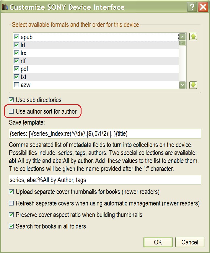

Hi GMRabelink in order to help everyone and get input from everyone these conversations need to be in the main forum.
Originally Posted by GMRabelink
I ended up with the following Metadata Plugboard:
Format: epub (Calibre won't accept device_db with PRS505?!)
Device: PRS505
Source template: {author_sort} {series:| - | } {series_index:0>3s}
Destination Field: authors
Destination Field: author_sort
Source template: {author_sort} {series:| - | } {series_index:0>3s}{title}
Destination Field: title_sort
I also have the Sony collection tweak set as follows:
# Specify how SONY collections are sorted sony_collection_sorting_rules = [(['series'], 'series_index')]
My 'Metadata management' is on 'Manual'.
My 'Save Template' is on default:
{author_sort}/{title} - {authors}.
You need to use device_db for this to work.
I also always have my Metadata management set to automatic, this way just connecting the device corrects the metadata on the device and under the device interface plugin you should have author_sort for Author unchecked..
It finally worked!
Turns out I needed to update Calibre to the most recent version...
I was still using version (something like) 0.8.13.
With that older version of Calibre, I couldn't combine the format 'device_db' with device 'PRS505'.
Calibre kept coming up with an error-message: The chosen format wasn't supported by the device. So I used 'epub' as format, since all my ebooks are epubs.
After updating to 0.8.21, I'm able to combine 'device_db' with 'PRS505' and everything turns out exactly as I would like it to be.
Thank you very much for your help!
