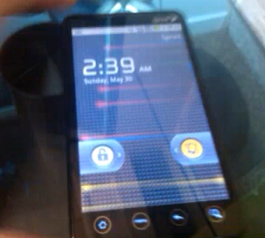

So I had no trouble with update itself, I just don't seem to know how to work it now that it is updated. It's "locked" and I don't seem to be able to unlock it, any suggestions? In locked mode nothing seems to function. New to all this, guess I should be happy I accomplished the update with no errors huh?
Any help would be appreciated. Thanks.
THough this picture is NOT an EE or PE screen, once upgraded to ermine the method of 'unlocking' and accessing the device is slightly different. In Dingo (Android 1.6) pressing the Menu button twice would unlock the device. In Ermine (Android 2.2) press Menu to energize the LCD and than press the padlock and swipe 'right'.

Originally Posted by Gunnerp245 View Post
THough this picture is NOT an EE or PE screen, once upgraded to ermine the method of 'unlocking' and accessing the device is slightly different. In Dingo (Android 1.6) pressing the Menu button twice would unlock the device. In Ermine (Android 2.2) press Menu to energize the LCD and than press the padlock and swipe left.
Gunner, since the padlock is on the left don't you mean swipe right?
GiGi4010, in swiping the padlock icon to the right make sure you keep contact with the screen until you reach the green dot.
ivanjt is offline   Reply With Quote

GiGi4010
Pocket Virgin
GiGi4010 is on a distinguished road
GiGi4010's Avatar
Posts: 11
Karma: 68
Join Date: Sep 2011
Device: entourage pocketedge
Hey thanks for those tips, I already reverted it back to 1.6 but nothing ventured nothing gained, I'll try the whole process again and see where I end up. Sure is nice to have someone to bounce questions off of, thanks so much both Gunner and Ivan, I'll let you know how I fare.

Gunnerp245,
You're a God among men! Who new such a little thing would be complicated. The menu button, padlock swipe worked great! Thanks to you and Ivanjt I can move on to the next hill, downloading apps to work for my needs. You guys really helped!
You are very correct! Fixed original post.
