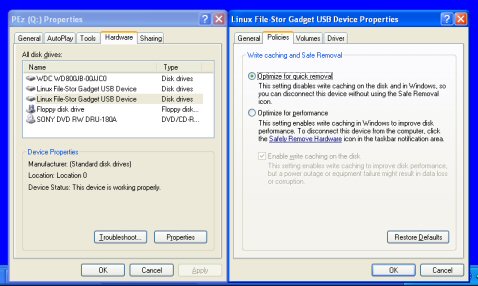

Windows may have decided to cache this drive (device) which is a bad idea for detachable drives.
Just because have control back, does not mean it is done with all the writing (the delayed write). Premature disconnection can really mess the file structure or database.
With the Kobo attached, Find the drive in My Computer: Right-click, Properties
Then select the "hardware tab"and find a USB device (not the PATA or SATA HD/DVD) select it and click Properties (in the Left picture)
The Right picture is what you want to see for detachable's.
(repeat for the other, similar device if there is a SD card installed)

Okay, Ducks...I went to where your image suggested, and that option was already chosen. I had my husband review this with me (he's an engineer and good with computers) and he doesn't seem to understand why this isn't working either.
All my drivers are updated, everything seems to be in order---it's just not working. It keeps dropping out every time I plug it in.

*edit* Two more things to consider. I'm wondering if my problem began with the random "there is a problem with your storage, please do a factory reset" message I got a few days ago. This was precipitated by nothing; one day I simply turned on my Kobo (hadn't connected to the computer, hadn't loaded anything onto it recently, just charged it) and got this message. Could something have borked internally?
Secondly, when I did the properties to get to the section you suggested, Ducks, it showed that my Kobo had zero used space and zero free space. I could see it on "My Computer", it made the noise when I disconnected, but for all intents and purposes, it's dead to it.
The Zero - Zero status indicates to me file system corruption.
