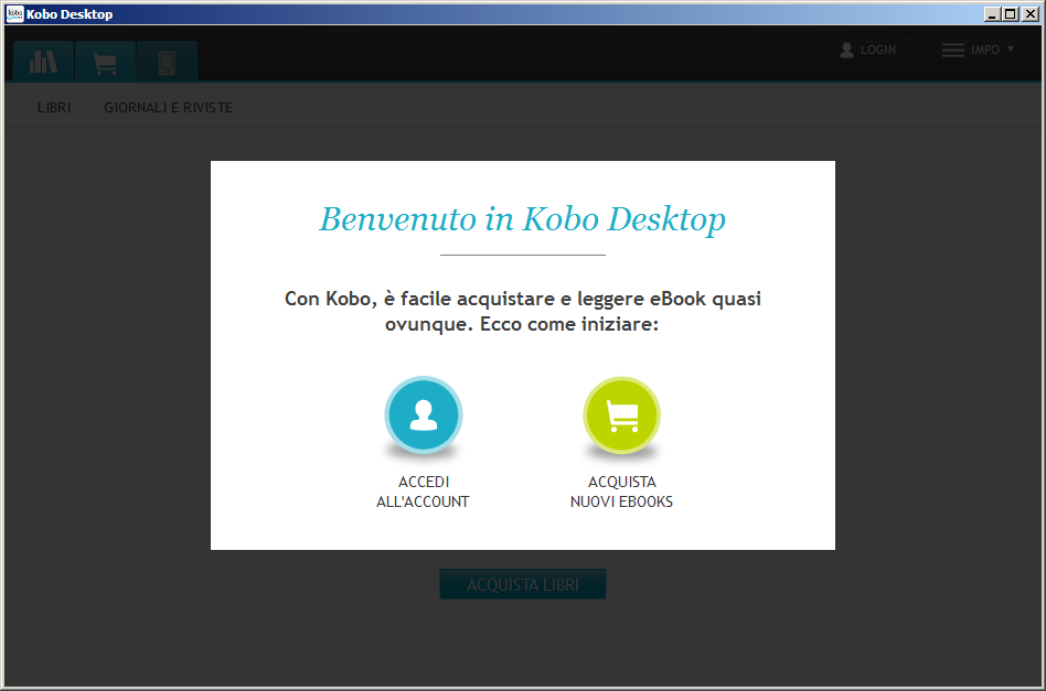

So I went to kobosetup.com, downloaded the PC version of the application, installed, rebooted, ran... and since the KT was connected it told me the KT was already configured to gave me an "Ignore" button that bring me on the "Account Login" or "Buy New Books" window (see attachment, sorry for the Italian). Since I'm in office, I've used Ctrl+Alt+P to activate proxy. The fact is that clicking on any of these two buttons performs no action. Nothing happens.
Any idea? At home, probably due to HW USB power (I also have to use external power supply for my USB HD) I cannot connect KT. At office, don't know why, I cannot use Kobo Desktop... I also have an Eee PC that perfectly connects to KT but since it is the original Xandros Linux I don't have the Kobo Desktop application.
Any idea? Any help?

Thanks! Didn't know this tool: cool! Results attached. It seems, briefly, that even if proxy is configured, connection does not work. Is there a way to specify proxy somewhere?
Line 5, I've started the application.
00000005 7.87510777 [3428] ApplicationBase::switchTranslator::loading locale: ":/translations/trans_it_IT"
Line 14, I've clicked the button.
00000014 14.00071621 [3428] BTMMHOOK 16.09.2011 09:31:04 Thread<1AF4> Hook DLL loaded
Nothing happens, after a while (see the timing, 40 secs) there is a timeout... but nothing can be seen on the screen.
00000019 56.32960510 [3428] NetworkReplyObserver:nError 99
00000020 56.32971191 [3428] WebResponseInflater::webRequestFinished FAILED 99 "Connection timed out"

Thank you!!! Got it!!! I've modified IE proxy configuration to use a specific IP instead of the script we have... and it worked!!!
Well, at least now I can see the main screen. It still tells me it cannot connect but now I have the whole thing working.
Now I can uninstall and configure it properly.
Indeed, I'm wondering why my colleague still has such script... and his works!
