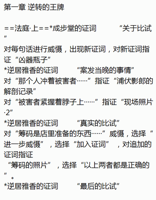

As they say, a picture worths 1000 words. I think it's better for me to post the pictures here. The 0.gif is what I've generated, and the test.gif is what I got from Photoshop.
They're with different text contents and in Simplified Chinese. But I think you can see the idea behind it. I don't think bolding the font would work, as Photoshop doesnt need to do so.

OK, I took your 0.gif, rescaled it larger by 300%, blurred it and shrunk it back by 33% (I couldn't do 33.33333%) and got the following 0-new.gif.
Is this better than the photoshop one, on your ereader?
If it is, then you should perform your image manipulations at a higher dpi (dots per inch), then resize back down to your final size.
