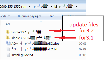

There are only two different system apart from original KindleOS.
If you want to install both Duokan and Duokan lite:
First install Duokan
1-Copy folders: DK_Documents,DK_Pictures and DK_System
files: update_duokan_ObOOa.bin, update_duokan_0b006.bin and update_duokan_0b008.bin
2- update Kindle
Switch to Kindle Sytem again
Then install Duokan Lite:
1- Copy folder DK_System as a whole. ( Approve overwriting the existing ones, etc)
files:update_duokan_ObOOa.bin,update_duokan_0b006. bin and update_duokan_0b008.bin
2- update again
see: update files for DLite:
Name:	Untitled picture.png
make sure that hacks are not installed (including jailbreak)

Thanks for very clear instructions. Now when one plays a lot and does not keep notes, strange things happen. I uninstalled only jailbreak, left launchpad alone. Followed your instructions and all went fine.
Now launchpad is still running (jailbreak is uninstalled though). The switcher is still acting funny, that is sending input to multiple systems. How do I get rid of it? Just remove the switcher files and use old dklite files for launchpad, I guess?
