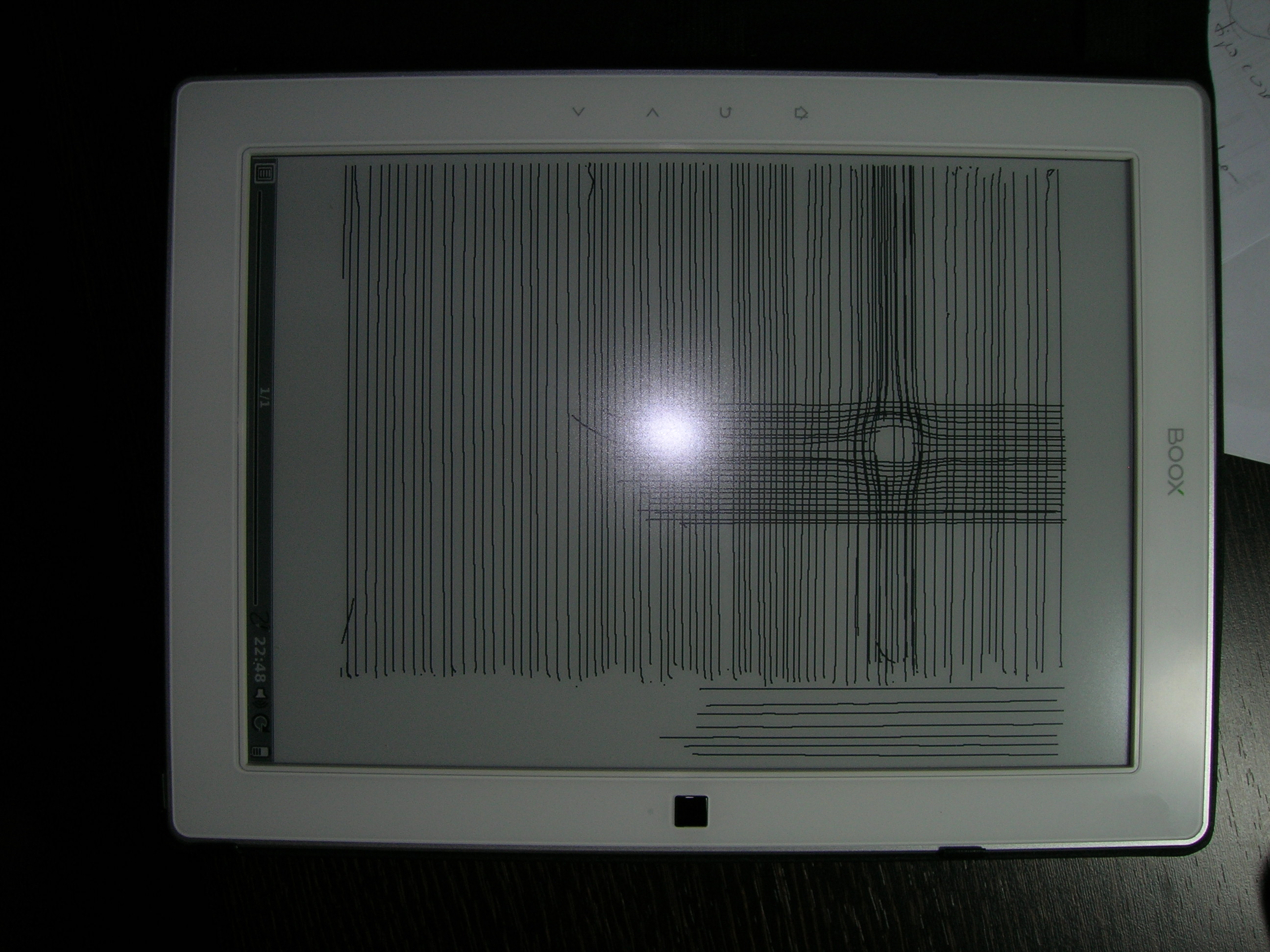

I have detected a problem in my M90 when I use the pen. There is a region in the middle of screen where the image is deformed, and even worse is not possible to write at all (black hole).
I detected this problem writing notes. Latterly I decide write parallel lines to detect other malfunctions.
This problem also appears when you write note by hand in any pdf file.
If you zoom the area the problem remains in the same physical space, and is not displaced to other regions.
I think the problem is related with the wacom
May other people check it? (to see if it is a problem from my device or is general).
Attached I send a photo where appears the lines deformation.

This is a general problem - the dead spot is vis-a-vis the speaker. Take out the speaker and it will be fine. (seen on a russian forum).
yep, the designer wasn't the sharpest tool in the toolbox. Using singular form here, since a designing team would surely do a better job.
I would advise the designer to look for another job, if he is not fired yet.
Unfortunately, this flaw is nearly impossible to (completely) solve with firmware updates, as is the one with the IR sensor (in a lesser extent).

The speaker problem is easy to solve with hardware, a little shielding would do the trick. I wonder if they will deal with it. As with similar things this one is likely not to show up on all units.
