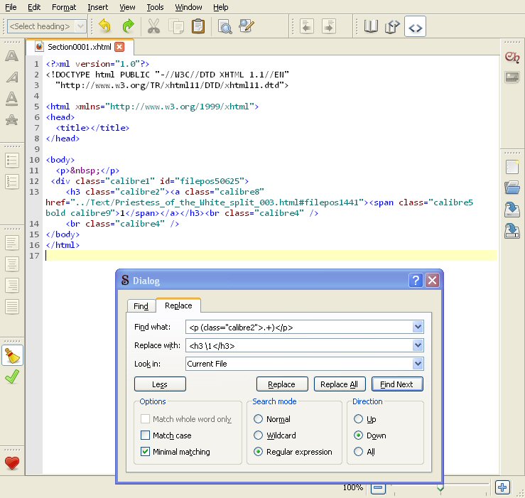

I pasted your code into Sigil 3.4 and My terms into the S&R.
I then Searched. Verified what it found...
Then I clicked Replace
you can see the results
