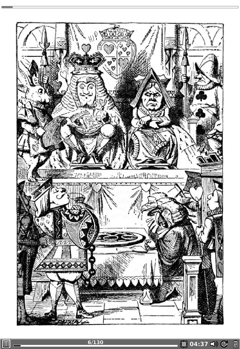

forgot Snapshot
If you have and SD card in the device you can take a screenshot of the page you are on by pushing the middle of the volume rocker so that it pushes both + and - together. If you get the speaker icon on screen you havent got it right.
these are stored on the SD card in the "snapshot" folder which is created the first time yo take a screenshot
here is an example showing the small margin note i made near the king in this page from Alice, using zoom in, write and then zoom out
