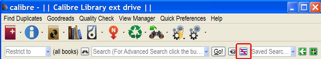

Just installed the Duplicates plugin but found I am having a problem now when I try to search for an author. Running Calibre 0.8.6. The duplicates find was great but after running the plugin how do I return to the normal library display.
I restarted Calibre and now when I say search for an author Calibre highlights that author but shows every other book in the library whereas before it only show those books by that author. What am I doing wrong?
Toggle the blue stripped icon in the top row, see attached.

Questions re Duplicates.
Just sorted the answers myself (Enable/Disable Search Highlighting).
