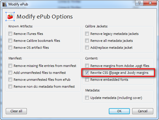

v0.3.4 Beta
Changes in this release:
  • Fix issue with some NCX files not parsing correctly causing error with OS artifact removal
  • Remove dependency on the Calibre epub-fix Container class to allow plugin to develop independently
  • Incorporate Idolse's rewrite CSS margin code to reset page/body margins
This version includes Idolse's work on the page/body margins stuff, which I believe now reads your Calibre preferences for page margins and then adds them into the CSS stylesheet. As it stands currently this code only looks at the CSS files for .body/@page directives - any that are specified inline in the HTML page are not considered. Investigation still ongoing for the latter.
@Idolse - as mentioned above I have (for now at least) made this a separate option within the dialog. We may decide to roll them back together in future but at least this way people can test in isolation.
