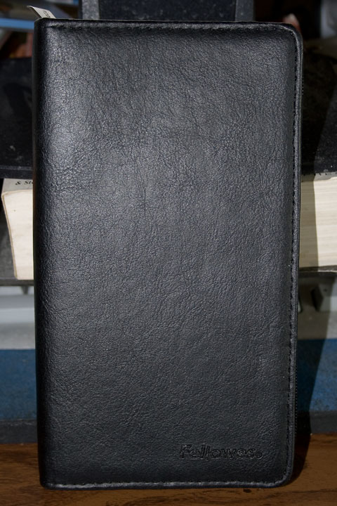

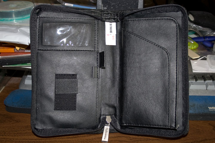

Which is why I went ahead and *BOUGHT* a Fellowes Travel Folio from the online Target store. As I didn't get the Bookeen softcover case - yet! - I figured I'd avoid any repeat of my 'dropping the Cybook' incident with this very *NICE* zippered case. And it only cost $14.95 (plus s&h)!
Derek
