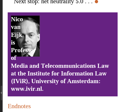

Hi all
We have some text + a pic in coloured box that appears at the end of various articles within our ePub. It looks good in iBooks (see screenshot attached) but breaks down in ADE.
The code is as follows;
<div class="story rightFloat">
<p class="biography-in-blue-box"><span class="bio-blue-box-pic"><img alt="nicovaneijk.jpg" class="rightFloat" height="139" src="../Images/nicovaneijk_fmt.jpeg" width="98" /></span>Nico van Eijk is Professor of meh.</p>
</div>
and the CSS is;
p.biography-in-blue-box{
background: #662282 !important;
color: white;
font-weight: bold;
padding:0.5em;
margin-right:30%;
line-height:1.25em;
-webkit-hyphens:none;
span.bio-blue-box-pic{
width:100%;
float:right
Can anyone see how I can get it to work in ADE?
thanks,
Iain
It may look good to you, but it's not floating or, at least, it's not what one intends when using floats.
The thing is you are using "width: 100%" for the span, so it takes the whole width of the paragraph, leaving no room for text. iBooks places no text there and skips until below the picture, while it seems ADE is placing always a word at least on each line.
I'd use something like:
  display: block;
  text-align: left;
I use "display: block", because you cannot use a <div> inside a <p>, but you could assign the background colour, etc. to the outside <div> and put the picture in another <div> before the <p>...

Thanks Jellby - I changed the span definition with my existing code and it is now working. And I can understand how it works. Brilliant - thanks!
