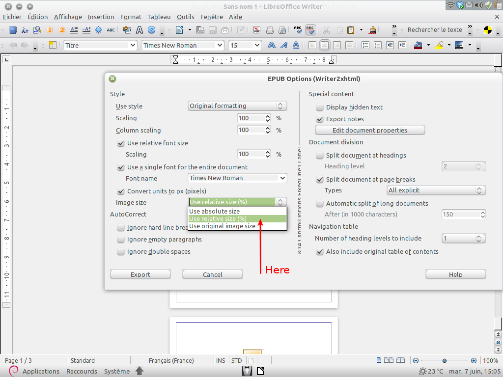

W2X, short for writer2xhtml, is an extension of OpenOffice.org or LibreOffice. Free and multiplatform.
More info -in French I'm sorry- with my signature.
Joint is a photo (click twice) of the option to be selected in the export panel of writer2xhtml (other options are available.. )
Your source file has to be in odt format. You directly export to EPUB without any code tweaking. You can check you EPUB though with Sigil.

The complete name for the extension is writer2xhtml.oxt. You'll find it in a folder containing other very interesting items but that you do not need to install if you just intend to produce EPUBs. Just unzip this folder and look for it.
Current version is 1.1.7. The 1.1.8 will probably be published end of July.
The main idea is to use LibreOffice with styles (and style too !!) and then you just export to EPUB. I'll be happy to give you any info about it.
