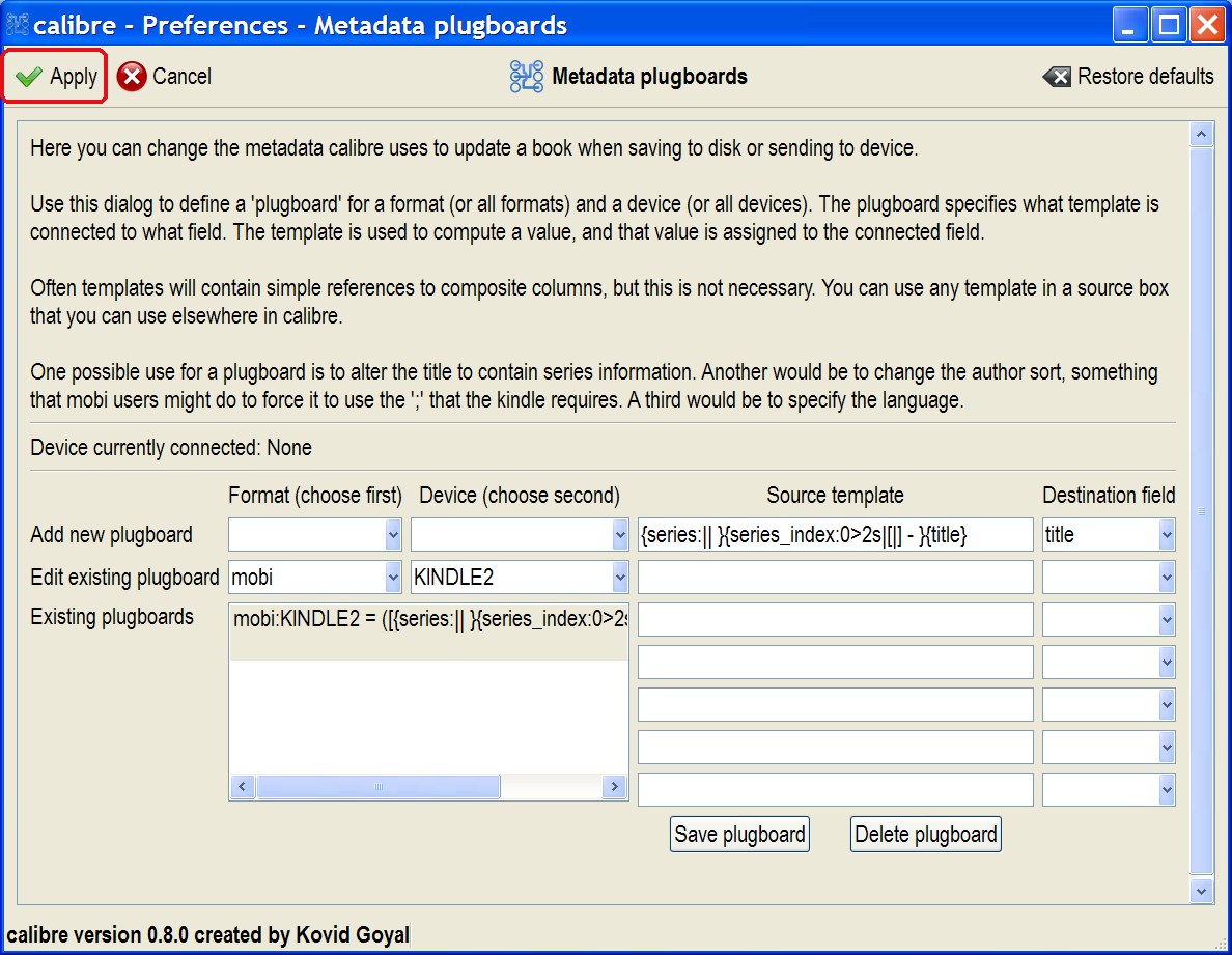

Hi all, I need some help in choosing the right template for sending books to the kindle with series and series index in the title. I had to reinstall windows on my computer consequently calibre needed to be reinstalled so i lost all of my settings. I think i used this template "{series}{series_index:0>2s| - | - }{title}" before and my books were in this format
"A Song of Ice & Fire - 01 - A Game of Thrones
A Song of Ice & Fire - 02 - A Clash of Kings
A Song of Ice & Fire - 03 - A Storm of Swords
A Song of Ice & Fire - 04 - A Feast for Crows"
Please help me figure out how to set the metadata plugboard to send the books like the above format. Thank you
To do this I use the info under the General Metadata spoiler in this sticky post.

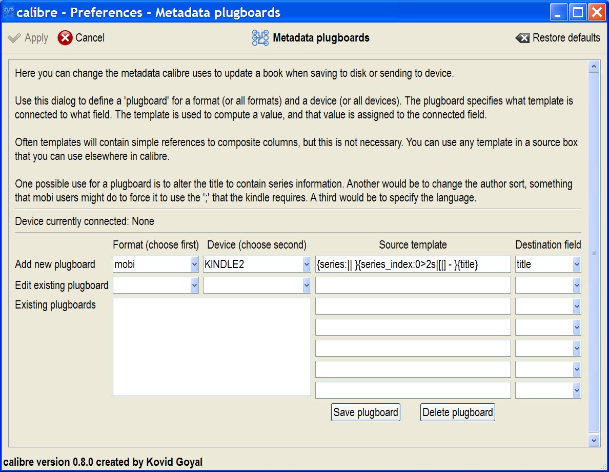

I tried it but it does not for me...
So you entered the plugboard like image 1 and saved so it looked like image 2 and after you save it did you click the big green Apply check in the top left corner? Then connected your Kindle and sent some books to see if it worked?

Thank you dwanthny, It is working now. For the device section I chose "Kindle" instead of "Kindle2" since I have a kindle 3; so I'm guessing that was where the error was.
