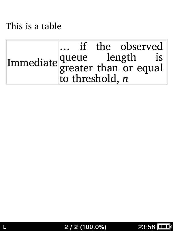

My Sony PRS650 doesn't seem to have any problem at all displaying an epub created using Calibre to convert the html file as listed in your post.
I have added some screencaps to show you the results at different zoom levels.
I wonder if different readers have different abilities with tables?

Thank you so much for letting me know about that!
I see the problem on the ipad and when I view it with the Mobipocket Reader (in columns view). I wonder why we're seeing different results.

Mobipocket Reader is not an epub reader. It converts epub to mobi under the hood. And MOBI's support for tables is very limited. If you want to view an epub file on an ipad dont use mobipocket reader. Use ibooks or stanza or any one of half a dozen other epub reading apps.
