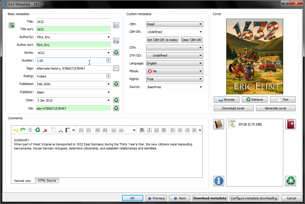

Just for fun ...
For fun, I added a third edit metadata (single) dialog, this one showing all information on one tab. It is convenient as long as one has a rather large screen (works fine for me in 1280x1024). This dialog is in trunk now, and will be in the next release.

@Charles - now that is how I like the dialog laid out. Im not at my pc to try it yet but is it possible somehow to hook that into the E shortcut to appear instead of the other one? Or does it have it's own menu and shortcut. I would rather only use this one via the normal key shortcut or toolbar button click if possible...
"Preferences -> behavior -> Edit metadata (single) layout" sets the dialog that opens with shortcuts or programmatic access. There are three of them: the default, one that puts standard and custom metadata on one tab and formats & cover on another, and this 'all on 1' version.

I wonder if Kovid would consider adding Select All / Select None buttons to the metadata configuration dialog for the global set of checkboxes? There are times where I want to just get a rating for a book and leave all my other data untouched, and then switch back to getting everything.
Also I have been caught out a few times with this if I forget to tick the options back on and do download metadata on a new book and wonder why it hasn't populated other fields I was expecting. I don't have a super answer to this, other than to somehow show on that initial metadata download question dialog a comma separated list of the metadata fields that are set to be populated? It would act as a reminder to jump into configuration to fix them.

@kiwidude: Added a select all/none button pair
Did I already say I love you? I love that single metadata edit dialog! I already liked the sleeker looking second one, but when I edit my metadata, the main data only gets added once (when I import the book). The custom metadata is what is edited more often and that being on the other tab always felt too much work...
