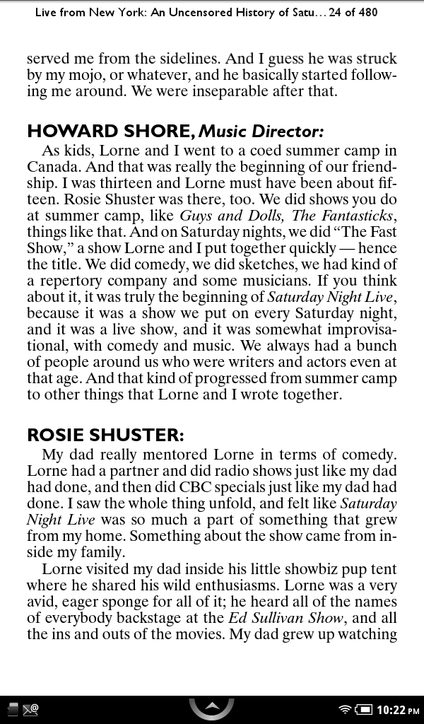

I updated the Nook Color to 1.2 yesterday and noticed that there seems to be much more hyphenation (words being split at the right edge of the page going onto the next line) than there was before. Maybe it was always there and I had never noticed it, but it's driving me crazy. I run all of my EPUBs through Calibre, even store bought ones, in order to standardize font sizes across all of my books, could this have anything to do with this? Is there a setting within Calibre that controls hyphenation or something similar or is this more likely the reader app itself on the NC and some new value causing it?
EDIT: Just as a test, I downloaded one of my archived books and read it without any conversion. The hyphenation is just as bad, if not worse. On average there are between 5-7 words being split on each screen.

Thank you for the suggestion but it doesn't seem to have any effect on the problem. I tried both books that I've converted from other sources, B&N books that I've converted, and the same books from B&N with absolutely nothing touched with publisher defaults both on and off.
I've had the NC since it was released and have been through all of the settings many times and I had never noticed or had any issue with hyphenation. There doesn't seem to be any option on the NC to adjust justification, this could have something to do with it.
As an example, I attached a screenshot from a book I bought from B&N with the publisher defaults set to on, so this is exactly the way it is meant to look with no fonts or margins adjusted. What I'd really like to know is if anyone else is seeing the same thing after the 1.2 update or it was always like this and I never noticed.

That doesn't seem like a very good example of extreme hyphenation, at least to me. I only count 4 on the entire page.
One thing I do notice about it is that it is blocked left and right - i.e. each line is spread out over the entire area with an even right margin. On epub files you yourself have control over, you may be able to specify how that operates somewhere in the epub file (probably in the .css style file). I think it is hard to decide which kind of blocking causes more hyphenation.

I agree with RAH. Somewhere in the settings it is set up for FULL justification. I would find that and turn that off. Having it set for Left justification should fix that situation. I also do not like a lot of hyphenation, but having it set to Full requires the document to use every inch of space to the right margin. Usually though, because of that there would be extra spaces on some lines so that it will stretch all the way to the right margin. I am not seeing that in your screenshot.

1.2 included an update to RMSDK 9.2 which improves the typography by including (among a lot of other things) a hyphenation engine. If for your epubs you don't want the hyphenation engine (and the better typography, etc...), you can force RMSDK 9.2 to use the 'old' 9.1 text engine by adding adding the css attribute 'adobe-text-layout: optimizeSpeed;' to a body selector ie
body {
    ... other attributes ...
Jim Lester is offline   Reply With Quote

THANK YOU! I added that line to the EPUB file I was testing above and the hyphenation is back to exactly how I remember it before, i.e. none.
To those people commenting on the example I used and saying that it doesn't seem like a lot, you are right, but what I meant was that the books were going from having absolute no words being hyphenated on each page to 5-7 words on each page which in my eyes was a lot. I just personally find it distracting and wasn't happy with the fact that it suddenly appeared in the 1.2 update.
