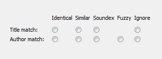

I prefer screenshot 2, but changed to something like the following:
I didn't bother to write code to center the radio buttons in the grid.
This example shows 2 things. The first is the use of common column labels, making explicit the coupling implicit in columns. The second is introduction of soundex for author names, which seems reasonable, given that soundex was invented for names.
I prefer the column layout even if you don't want to add soundex for authors. In this case I would have two empty holes in the grid. What I am trying to achieve is common headers.
An alternate that might work better for me is shown below. This one avoids the notion of columns and rows, instead using groups. I think this layout reduces the semantic coupling between the two sets of options caused by the row/column layout.
However, both of your proposals work. I won't be unhappy if you pick either one.

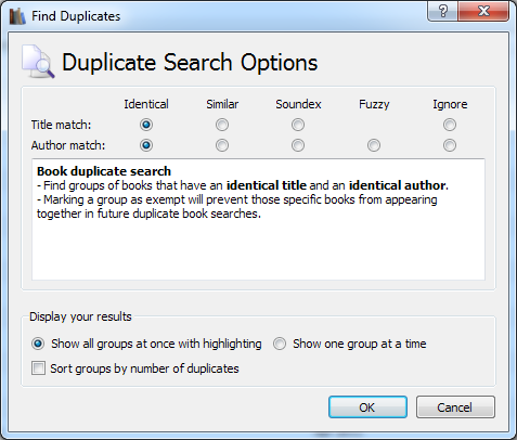

Ok, attached is your first variation. I do agree with you that the second variation (which is what you suggested ages ago) is probably the better bet though. The only thing I had against it was ending up with a more "vertical" dialog. However thinking about it now it really wouldn't be that much taller.
We shall see what I end up with when I push 0.6... haha. The plumbing is all done supporting all the various permutations etc, I just need to start tuning the implementations of the algorithms.
@dwanthny - thx and I agree that of the two I originally presented the one you picked was my preference too. However I could be swayed into the second of chaley's suggestions. I just think with the approach I have taken the brain has to do a little more cross-referencing (particularly when stripping out the second row of titles). It is more concise in layout, but perhaps at the expense of ease of use.

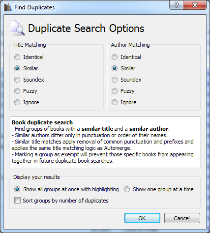

kiwidude is offline   Reply With Quote

Yeah I was thinking of just boxing the node to ensure it is visible, no searches. In a similar way to what my user category plugin does. So it would be a call to "self.gui.tags_view.model().find_item_node()" then "show_item_at_path()" or something like that.
All settings are persisted in the config file as soon as the user clicks ok in the dialog so yes everything is "remembered".
Sounds like we agree the user needs an option to disable the tag browser integration. It is just how that would interoperate with changes to the type of title search that I'm not clear about.
The simplest option would be a single checkbox that says "Show the first author in each group in the tag browser". This would take effect regardless of the type of search.
The second option would be to name it "Show the first author in the tag browser for ignore title searches". As per the name, doing anything but an author duplicate search would never manipulate the tag browser.
The third option would be to offer two checkboxes. One for "ignore title searches" and one for "title searches". We could enable/disable the appropriate checkboxes as the user switches the title match radio buttons so the user knows which is relevant.
I can't think of how a setting which changes each time you click a radio button can sucessfully work in combination with a "remembered" setting without the user wondering wtf is going on?

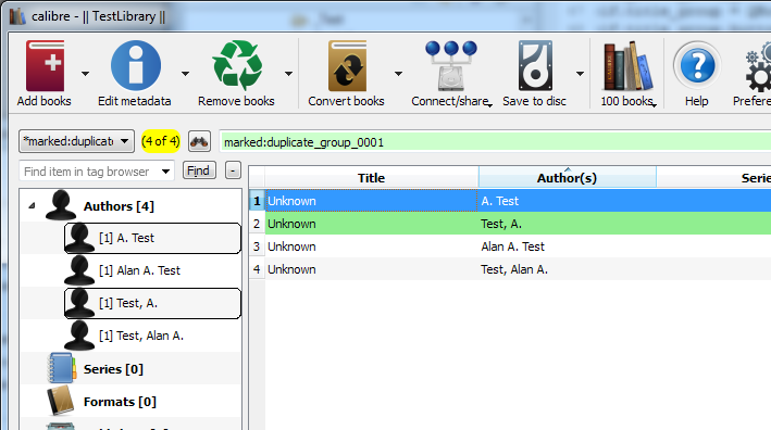

After more thought I propose the following:
My original requirement was the most likely scenario of a user doing an ignore title based search (so looking for duplicate authors) and on finding a group wanting to rename the authors involved. Forget about tag browser authors for title based searches. Yes it is "possible" a duplicate author could be found that way but the workflow I would always recommend is to do your "ignore title" searches first which should ensure any author renaming is already handled. Then focus on looking for various title matches with identical authors.
So... a checkbox related to just author based searches should do the trick of "Highlight authors in tag browser for ignore title searches".
I then decided to draw boxes around *all* the authors in the current group in the tag browser. I think that works REALLY well to give visual focus to just the authors under consideration for this group. Obviously it doesn't apply to when viewing one group at a time, as all the authors would be boxed. Though I think it appropriate to have the tag browser visible and authors node expanded ready .
One decision left... should I offer people want the ability to tune the fuzziness of their soundex matches?
