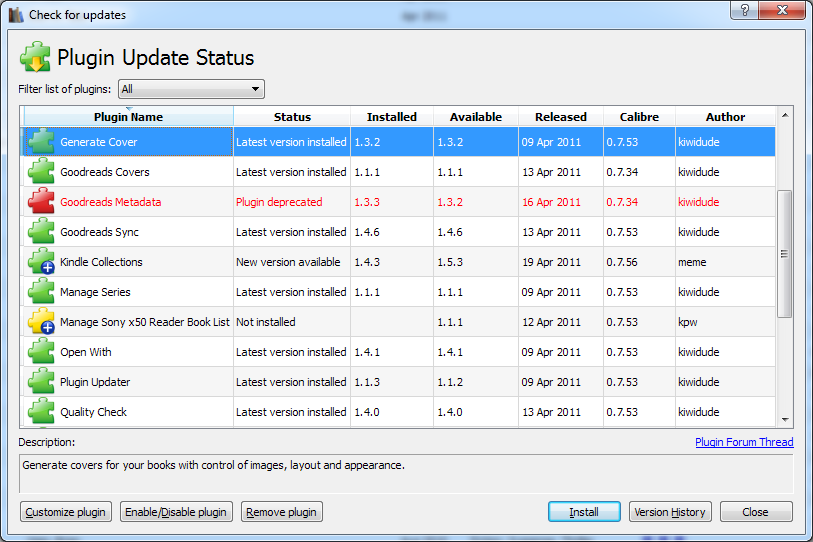

However there is still the other scenario of where a plugin gets renamed or combined into a new plugin. The most recent example is "Kindle Collections" which was previously known as "Create Kindle Collections". I will shortly have an additional scenario of "Goodreads Metadata" and "Goodreads Covers" being replaced by a new metadata source plugin called "Goodreads".
I have made the changes to plugin updater to support a "Deprecated" value on the index page, and placed an additional greyed out section on the plugin index page at the bottom where such plugins will go to "die".
With the changes I have made, if it sees that you have one of these plugins installed, it gets a special icon and appearance as per the attached screenshot. It will show up on the "All", "Update available" and "Installed" views. If you either (a) install it's replacement using Plugin Updater, or (b) uninstall it, then it disappears and will never be visible again on the plugin updater dialog (well unless you reinstalled it manually outside of plugin updater).
I have also added support for multiple uninstall plugin targets, so my Goodreads plugin will have "; Uninstall: Goodreads Metadata,Goodreads Covers" on the index page and both those plugins will get uninstalled. [Note that I will only put that attribute on there when Calibre 0.8 is officially released, as it is valid to have all plugins side by side for users who are just temporarily testing both].
Before I push the new Plugin Updater version, any objections to the above?

So if I understand the image correctly, I am being prompted to untinstall "Good Reads metatdata" which is in red?

I cant tell from the screenshot if you have already done this, but it would be good to have a message saying the plugin should be uninstalled when the user clicks on a deprecated plugin.
Also IMO, having it in red is a little scary. May be better to have it grayed out like firefox does in it s plugin dialog with plugins that no longer work after an update.

@Nyssa - depends on your definition of "prompt" but yes, it is a visual warning that you should uninstall it. And in normal usage of the plugin updater (such as installing its replacement) that uninstall will happen automatically. The text that will appear in the description field will tell the user exactly why the plugin has reached this warning state and what they should do about it (such as the name of the replacement plugin or whatever).
I don't want such upgrades to happen automatically because there are people who want to be conservative in upgrading and not necessarily grabbing the latest as soon as it is available. This was the best compromise I could think of to keep the user informed without having plugins disappearing without them knowing why.
Yes the tooltip tells you, as well the description for the plugin at the bottom.
The problem is that I already use grey for disabled plugins. Or do you want a compromise of the red icon with grey text?
kiwidude is offline   Reply With Quote
Old 04-23-2011, 10:44 AM   #73
Posts: 46,375
Karma: 29630884
Use another color, blue perhaps? After all having a deprecated plugin is not a critical condition, so red seems a little excessive

Blue it is.

Okay. Cool. It seems like you have all angles coverd, with both a visual cue and an explanation.
As an end-user, red would catch my attention more than blue, although I do understand your point of it being a non-critical issue.
Since you will be using blue, please make sure there is a color key added somewhere where the average end-user is likely to read it.
