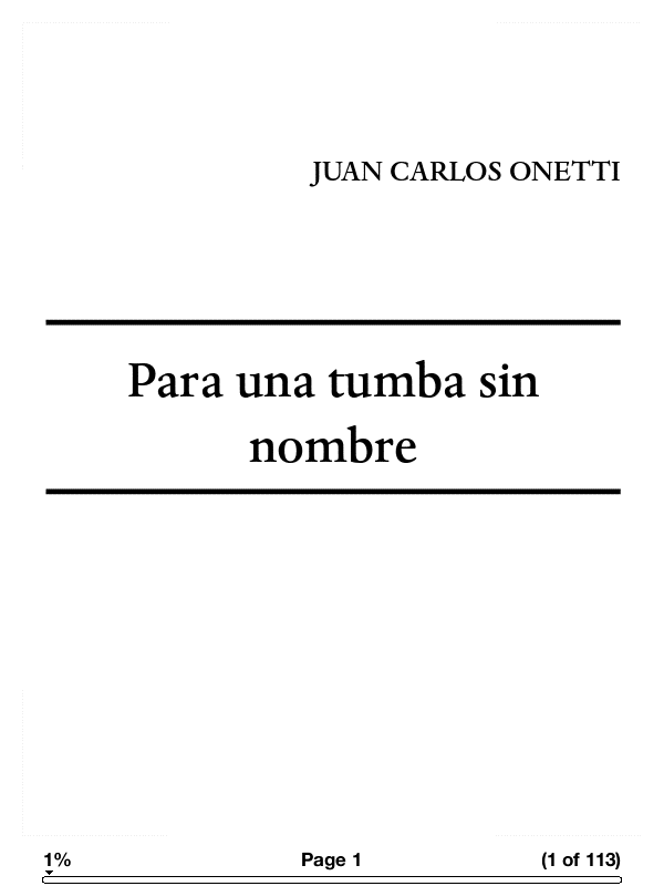

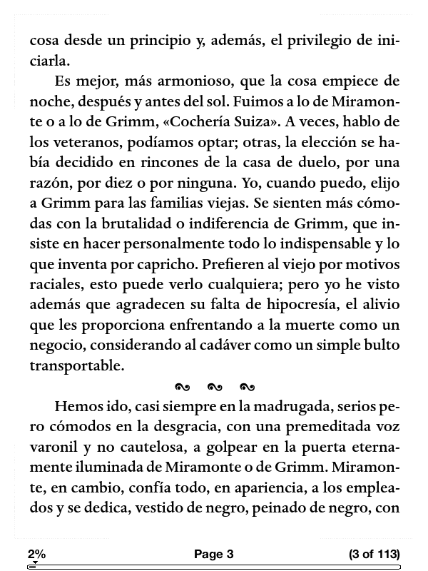

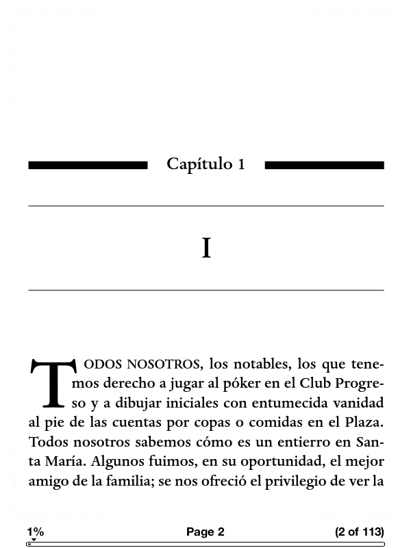

Thanks to all the latex gurus here (Valex et al), I have managed to create a satisfactory template (screenshots attached)
It has the following features: custom title page, custom chapter page, lettrine (with faked small caps), fleuron, generous white and invisible trims to prevent vertical centering.
It was compiled with MiKTex 2.9 and xelatex. To replicate the results, the font Dante-Medium has to be installed in the system. I am just learning so take the following code with a grain of salt:

\title{Para una tumba sin nombre}
\author{JUAN CARLOS ONETTI}
\date{1959}
\usepackage[spanish]{babel}

%Begin Chapter Style
\makeatletter
\newcommand\thickhrulefillm{\leavevmode \leaders \hrule height 1ex \hfill \kern \z@}
\setlength\midchapskip{10pt}
\makechapterstyle{VZ14}{
\renewcommand\chapternamenum{}
\renewcommand\printchaptername{}
\renewcommand\chapnamefont{\Large\scshape}
\renewcommand\printchapternum{%
\chapnamefont\null\thickhrulefillm\quad
\@chapapp\space\thechapter\quad\thickhrulefillm}
\renewcommand\printchapternonum{%
\par\thickhrulefillm\par\vskip\midchapskip
\hrule\vskip\midchapskip
\renewcommand\chaptitlefont{\Huge\scshape\centerin g}
\renewcommand\afterchapternum{%
\par\nobreak\vskip\midchapskip\hrule\vskip\midchap skip}
\renewcommand\afterchaptertitle{%
\par\vskip\midchapskip\hrule\nobreak\vskip\afterch apskip}
\makeatother
\chapterstyle{VZ14}
%End Chapter Style
%Begin Invisible trim
\definecolor{light-gray}{gray}{0.95}
\renewcommand*{\trimmarkscolor}{\color{light-gray}}
%End Invisible Point
\begin{document}
\scalefont{1.020}
\maketitle
\mainmatter
\chapter{I}
\aliaspagestyle{chapter}{empty}
\pagestyle{empty}
\lettrine[slope=0pt,findent=0em,nindent=-.4em]{T}{}
\small ODOS NOSOTROS\normalsize \scalefont{1.020}, los notables, los que tenemos derecho a jugar al póker en el Club Progreso y a dibujar iniciales con entumecida vanidad al pie de las cuentas por copas o comidas en el Plaza. Todos nosotros sabemos cómo es un entierro en Santa María. Algunos fuimos, en su oportunidad, el mejor amigo de la familia; se nos ofreció el privilegio de ver la cosa desde un principio y, además, el privilegio de iniciarla.
Es mejor, más armonioso, que la cosa empiece de noche, después y antes del sol. Fuimos a lo de Miramonte o a lo de Grimm, «Cochería Suiza». A veces, hablo de los veteranos, podíamos optar; otras, la elección se había decidido en rincones de la casa de duelo, por una razón, por diez o por ninguna. Yo, cuando puedo, elijo a Grimm para las familias viejas. Se sienten más cómodas con la brutalidad o indiferencia de Grimm, que insiste en hacer personalmente todo lo indispensable y lo que inventa por capricho. Prefieren al viejo por motivos raciales, esto puede verlo cualquiera; pero yo he visto además que agradecen su falta de hipocresía, el alivio que les proporciona enfrentando a la muerte como un negocio, considerando al cadáver como un simple bulto transportable.
\renewcommand{\pfbreakdisplay}{%
\decofourright\quad\decofourright\quad\decofourrig ht}
\fancybreak{\pfbreakdisplay}
Hemos ido, casi siempre en la madrugada, serios pero cómodos en la desgracia, con una premeditada voz varonil y no cautelosa, a golpear en la puerta eternamente iluminada de Miramonte o de Grimm. Miramonte, en cambio, confía todo, en apariencia, a los empleados y se dedica, vestido de negro, peinado de negro, con su triste bigote negro y el brillo discretamente equívoco de los ojos de mulato, a mezclarse entre los dolientes, a estrechar manos y difundir consuelos. Esto les gusta a los otros, a los que no tuvieron abuelos arando en la colonia; también los he visto. Golpeamos, golpeo bajo el letrero luminoso violeta y explico mi misión a uno de los dos, al gringo o al mulato; cualquiera de ellos la conocía cinco minutos después del último suspiro y aguardaba. Grimm bosteza, se pone los anteojos y abre un libro enorme.
