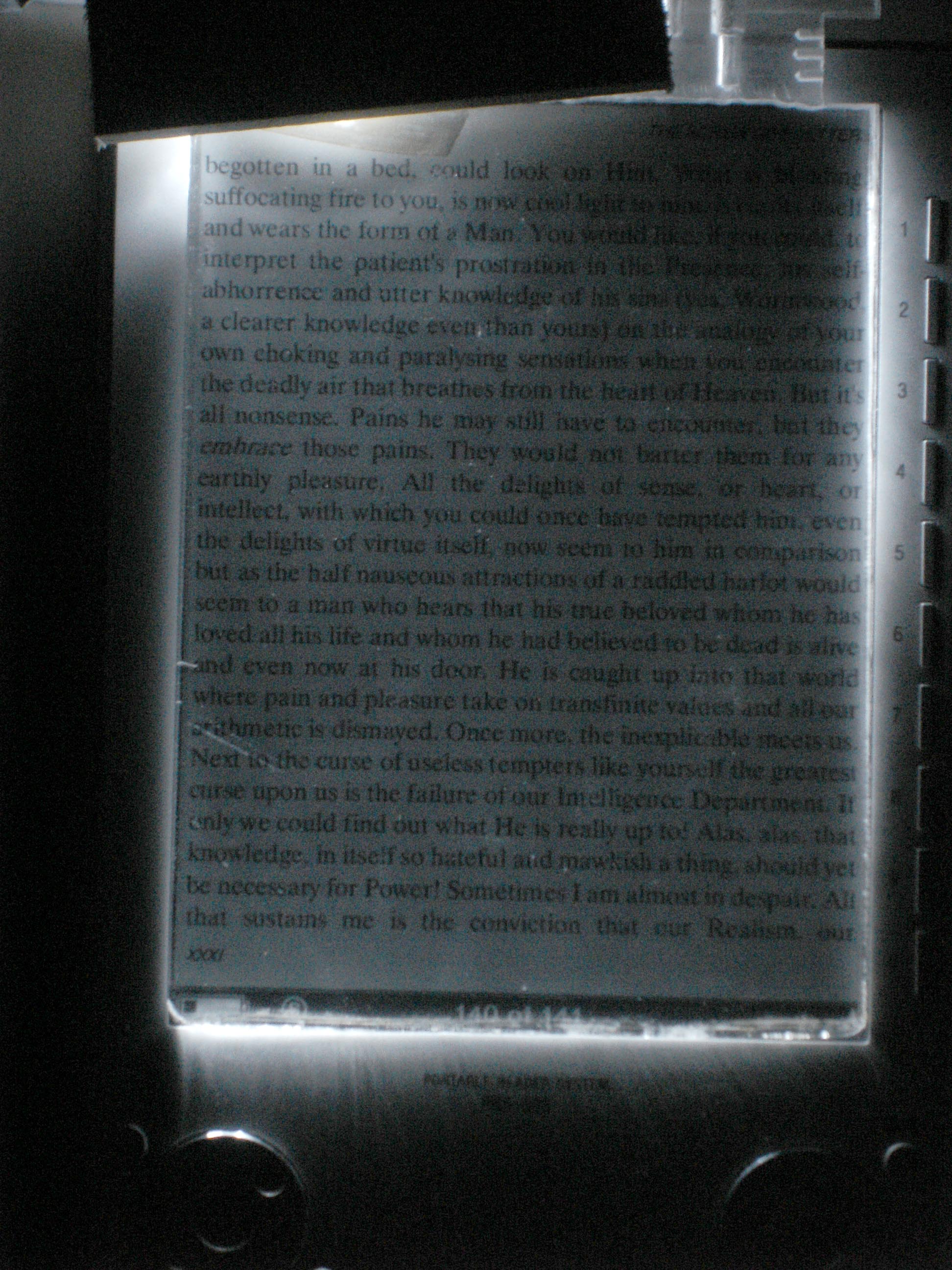

My wife was laughing at me when I started this project... I went out and bought a shiny new lightwedge to canabalise for its parts... then I went to frys electronics... for more victoms. She told me "Your the only person I know who buys things for the stuff their made of."
As far as LGP, that is the most generic term for what we are looking for. I have found a distributer that is willing to send me some samples... I just have to save up the money for the shipping costs, and my new twins are making that hard to do. I have linked to some pages that may be helpful at that companies website, and whatever else I could find that might help...

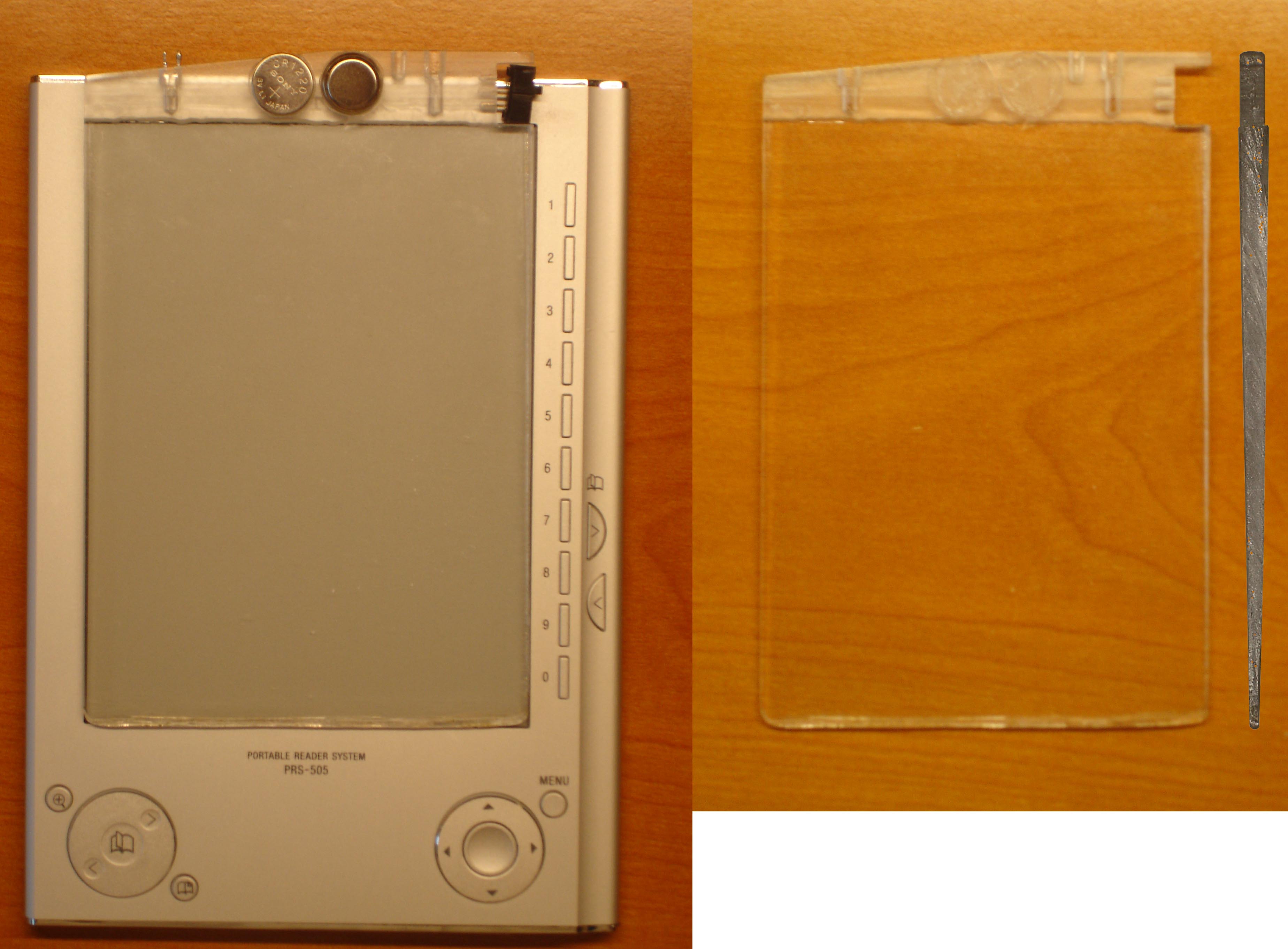

Originally Posted by mwBarlow View Post
They're called Fresnel Lenses and that might be a pretty good place to start investigating...
Thats what i thought at first as well, but thats not what this is. First a frensnel lense would make it look bigger, by refracting light in a circular pattern. and edge lit fresnel lense will not work very well (I have a 9x12 one about 2 ft from me from my first round of research about 4 months ago).
The group of devices that I have been looking at are described as light guides. That general term is any device that can in a slim form factor rotate a light source 90 degrees. These are bipolar transparent lightguides that take advantage of something similar to one way glass. There are other light guide designs that use small etched grooves to cause their refraction, while others still are using some strange grown crystline stuff. There are even talks of using the laser tech for polar light guides (like what is behind your LCD).
The lightwedge it using 2 principals, the major is its geometry, light bounces around in non parelle area till it can escape.. by then its all over the place... and second they have "tempered" the plastic to give it an optical bias towards guiding light out... but about 80+ % of the work is being done by the geometry.
So... what I have so far:
parts for 2 cost about 40$, and it would take me about 5-8 hours to manufacture 2 of them properly... still getting the kinks out of the current design.
These are half built, but i wanted to test some stuff out... That one of it lit up is with just one LED, to make sure the holes I drilled were letting enough light through.

This is looking great so far...
If you painted the edges of the light guide with a reflective paint (chrome plasticote??) that would keep the light from leaking out around the edges, and make more of it escape through the back to the display. making it more efficient.

It looks pretty good, how readable to you find it to be?
One thing I thought about trying was to "rough" up the "down" side with fine steel wool or sandpaper, to encourage the light to come out that side. What difference do you think that might make?

From my understanding of the lightwedge principle you really don't want to rough up either side of the wedge. You have to read through the whole wedge so any optic distortion, dispersion, or absorption is a bad thing (like roughing up or scratching my glasses). This sounded like one of the long term weaknesses of the wedge. Accumulation of scratches will eventually become distracting.
Think of it as a luminescent screen protector. Scratches are annoying with the lightwedge, but it is a decent material, and it is only getting scratched at times when the screen would be in similar peril.
I'm about 90% done, i need to make a metal battery cover, drill and tap 2 holes, and perhaps seal the paint.
The 2-3mm edges have proved to be a minor problem with some books, as they hit the margin just barely... In production I may try at lessen this to 1mm. The edges are covered with reflective tinfoil tape, then painted. The top is shaped, and then extra components were "shaped" by covering them with hot glue, and then masking tape. It looks pretty sharp unless you start trying to dissect it for flaws... and it still fits like a glove!
So what is a fair price for 20-30$ in materials and 3-4 hours of time?
ps(once im done i might run some battery testing to see how long they last... I can tell you it will be more than 10 hours, but i dont know how long...)

any pics of your light on top of a reader?
SurgE is offline   Reply With Quote
Old 02-21-2008, 12:06 AM   #30
NatCh
Gizmologist
NatCh's Avatar
Posts: 11,615
Karma: 929550
Join Date: Jan 2006
Device: Pocketbook Touch HD3
There's the one in post #20.
