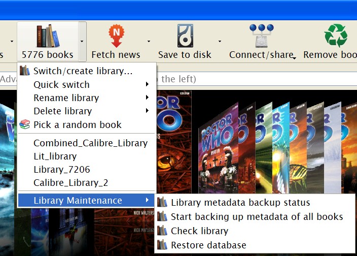

Those other metadata files are all opf files and yes these files could be used to rebuild your metadata.db (calibre database) by using the Restore database menu option under Library maintenance (see attached).
