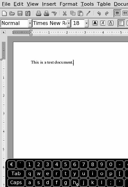

Old 01-22-2008, 05:24 PM   #21
Gogolo
Gogolo has learned how to buy an e-book online
Gogolo's Avatar
Posts: 353
Karma: 92
Join Date: Sep 2007
Device: DR1000S, Nook ST (rooted), Kobo Aura one (ksm)
I finally got Abiword working. But I dont see all the menues. After the middle of Documents the screen ends. Is this normal?
Sorry my english... look the image, my screen looks like this.
Edit: When I try to open menu edit/properties Abiword crashes.
Maybe I dont see the whole window because the menu is in german... "Datei/Bearbeiten etc." uses more characters. Can I change it to english?
Thanks
Gogolo
