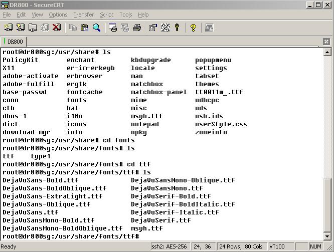

thank you!
And I connect DR800SG via WindowsXP.
here the Drivers.
