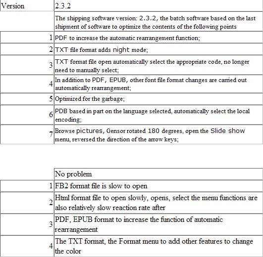

The changelog indicates the following improvements:
